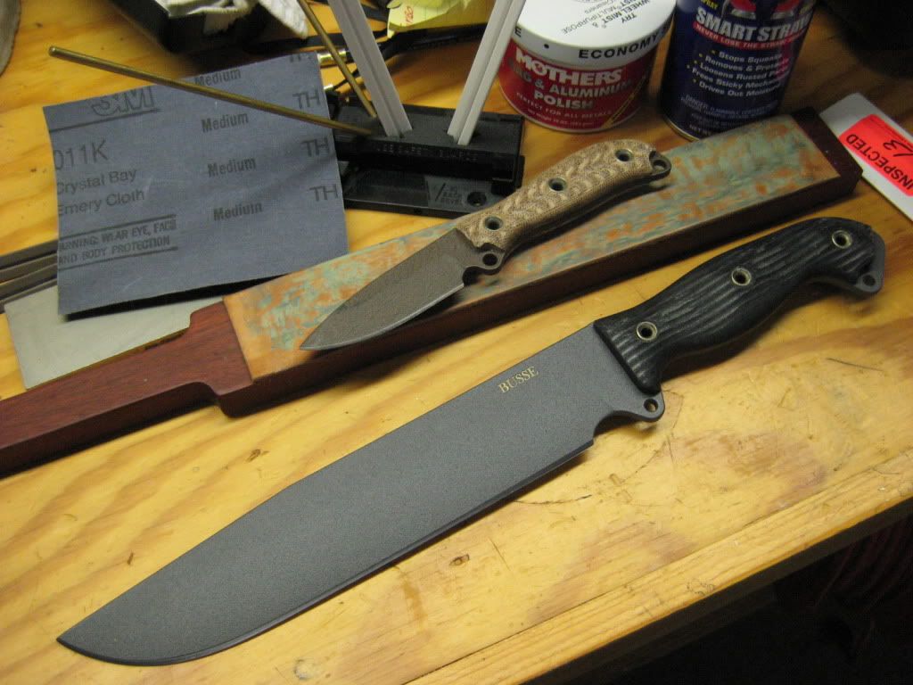

You may want to start with Mother's Mag & Aluminum polish. Apply with a Q-tip or rag, buff it a few seconds, and wipe off. I have given many knives new life with it. It will not remove deep scratches, but you will see a big improvement. Its very gentle but does the trick.
Ignore the knives - just showing the Mother's. :thumbup:
