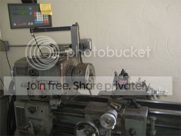

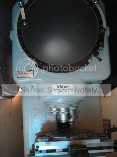

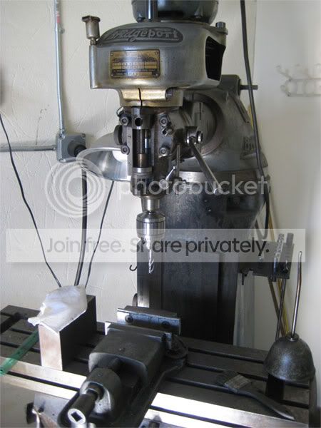

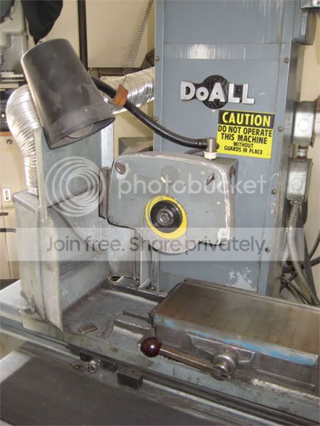

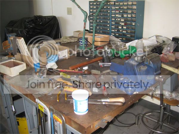

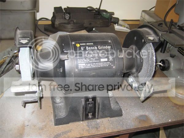

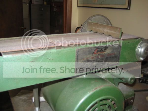

we have this stuff back there:
im interested in getting into knife making and im sure i can persuade my boss to let me use it during off-time.
I dont know how to use a mill but i want to learn. Where do i even begin to learn? What are the capabilities of some of these machines?
I'd say first thing is to see if your boss is willing to part with some of it. You've got some nice stuff there, especially the mill, surface grinder and lathe...:eek:
With a little bit of know-how, you could do a LOT of knifemaking with those tools. With the exception of a nice 2x72 grinder (and maybe a kiln), you've got a top-notch knife shop right there. I'd love to own the three items that Patrice mentioned. :thumbup::thumbup:
