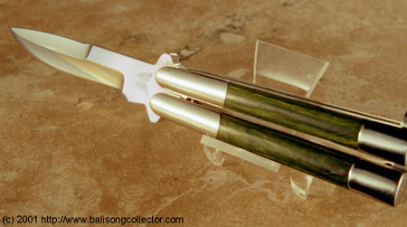

Did somebody say "Green Micarta?"
But of course.
