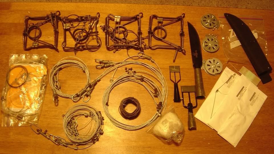

This is a picture of a larger snare/game kit. I've made a smaller one that is actually a soft-sided zip pouch (a set of three various sizes sold at Home Depot)...it's about 7x9" and when packed, about an inch thick (sorry no pictures yet):
8 small/medium snares
50 feet of brass (24 gauge) wire
Small Frog gig
2 Yo-Yo reels/snares
3 Speedhooks
550-cord, braided...about 12 feet
2 small titanium tent stakes (for anchoring if needed)
It's good for the pack but not a tin-sized PSK. I really like the frog gig!

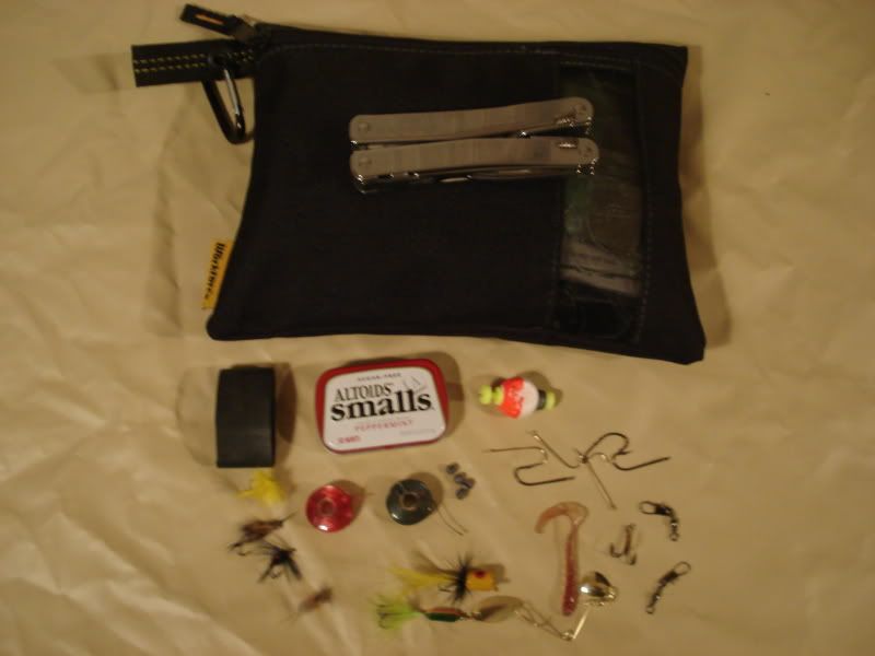

I also have a separate fishing kit (and just made a mini one yesterday)...here's the small container one (just a hair bigger than a film canister):
ROCK6

Here's a better picture of my smaller snare-game kit along with my mini fishing kit (still enough room for another half-dozen smaller hooks):
There are actually 12 snares in my kits (three different sizes).
I'm going to try out the mini fishing kit this weekend as we have a great over-hanging tree with a lot of little brim; I'll try both lures and live bait (crickets and grass hoppers).
