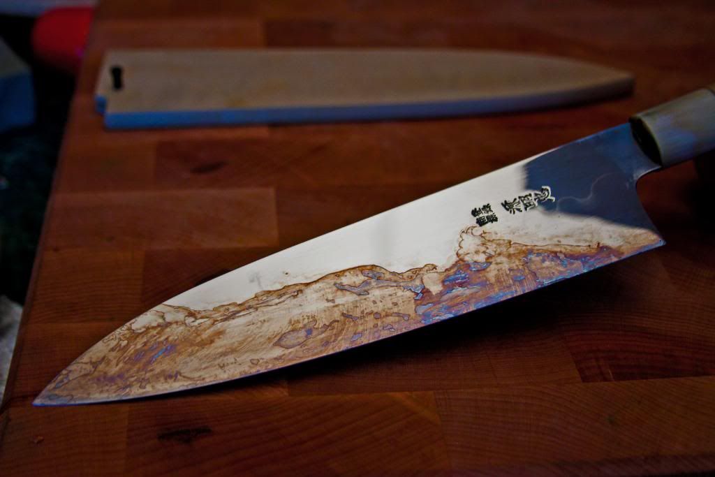

I've recently wanted to put a patina on a 1095 and M4 blade(yes, I do know they will take a patina differently). I've been looking through the forum and have really loved a lot of the natural patinas I have seen, like this:
Now, my two main questions the search feature and various forums haven't answered for me:
What constitutes a natural patina?
Details on how how to achieve this patina. Specifically preventing rust, and approx. time an application sits.
To elaborate:
I see many guys using (of course) fruit and vegetables on their knives, esp with culinary blades. But by favorite has been beef blood. I've heard guys talk about the reactions they have gotten by purposefully putting a patina on with beef blood.. Now does this still count as a natural patina, or is this forced?
This question is important to me, because it leads to confusion on how to achieve this without rust. Is a typical natural patina done on a blade that NEVER has an oil or protection on it? Is there a safe way to do this? Or are people doing this in timed increments, or details I'm not aware of. My only experience has been with mustard patinas that usually take a few hours or lime/vinegar/etc patinas that may take a few applications & less than 20 minutes total time. The blade is THOROUGHLY degreased, the patina is applied, and then the blade is washed and wiped with oil.
But building a natural patina or how that is typically (and hopefully safely) done, isnt something I'm knowledgeable in.
Much appreciated, thank you

Technically, I suppose the way to get a "natural patina" is just to use the knife for many years and allow it to slowly build over time.
If you're dunking the knife in vinegar, sticking it in a grapefruit, or anything like that ... then I suppose you would call that a "forced patina."
But who really cares? If it looks good and helps to prevent corrosion that's good enough for me.
I never heard of patina till this forum. I think we refered to it as "weathered".
My understanding is, patina developes with age and exposure to the elements. Quick staining is just, stain.
Eat a lot of steaks, use the knife and don't wash or wipe it down 100% each time.

If you want it all nice and even, then use hot vinegar just below boiling. Use a microwave safe glass and heat up some distilled white vinegar, enough to cover your knife blade up to the tang/handle, then dip your degreased blade into it for about 20-30 seconds. It will turn black. Take it out of the vinegar, rinse under the faucet, then wipe off with a paper towel (a lot of black will come off). Repeat if desired until it is the color you want. Then rub with a mineral-oil soaked paper towel (which may remove some more of it) and you are done. That is a "forced" patina.
