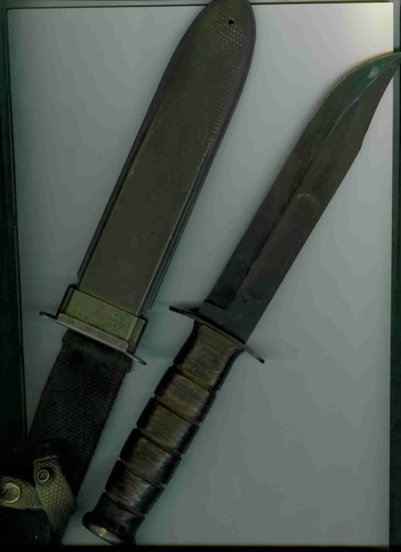

That is really unusual. My own Kabar (below) will shave a bald patch with no difficulty.
