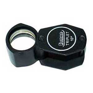

BeLOMO 10X Triplet and LumaPower LumaHunter M1-T.

BeLOMO 10X Triplet
Never heard of them. So I Goggled BelOMO and picked up a thread in Gemology Online. All the GIA folks seem to think they are the best, especially for the money. If I ever wear out my B&Ls, that's what I'll get.:thumbup:
I use the standard of the New York Diamond District, I Kassoy 10X Triplet USA.

I saw the Kassoy mentioned over on the Gemology forum, too. They are another recommended brand for the folks who sort and grade gemstones. The L609 model on the Kassoy website is very reasonably priced, too.
