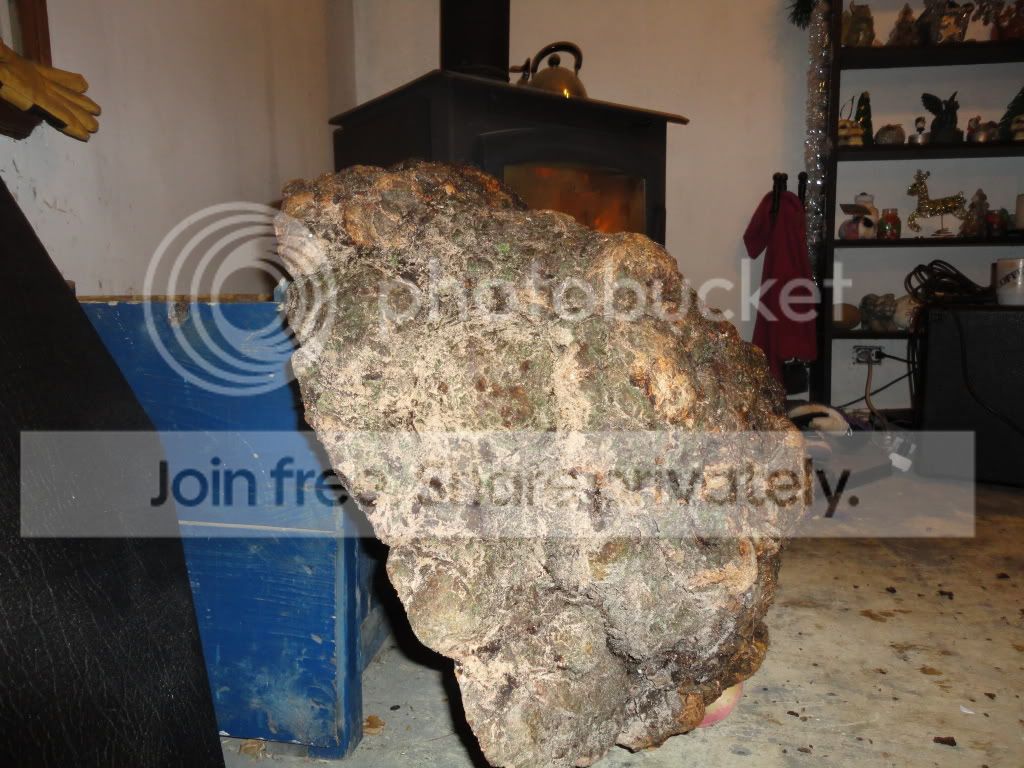

ive come across an iron wood burl, its very large
its from central ontario canada
Ironwood Ostrya virginiana, is the official name
the question is what to do with it
sell it? keep it?
if im to keep it, how do i preserve it for use, the info ive found states that it could take 5 to 10 years to dry, possibly more, unless i cut it up
id hate to cut it up if its better to leave it as is
any advice is better than what i have now
thanks, ill include some pics

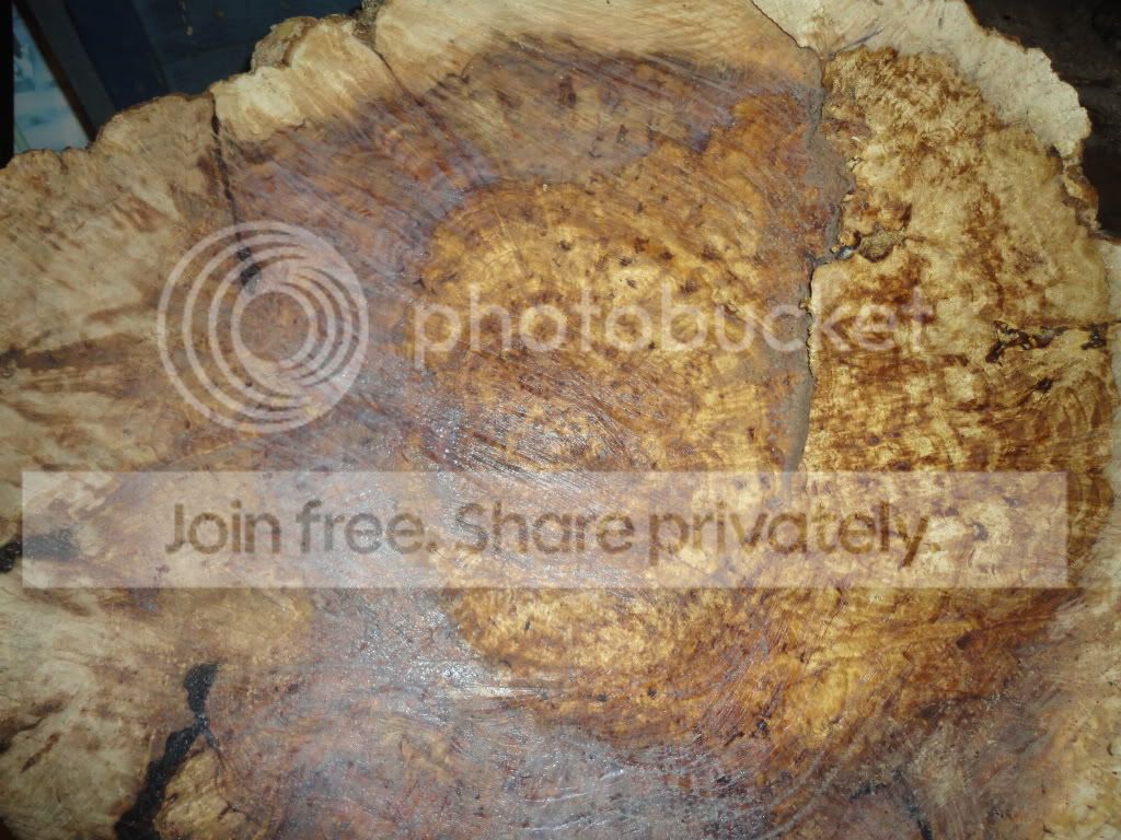

i sprayed some varathane to seal it

That's a very nice chunk o' wood!
Ostrya virginiana (commonly called American Hophornbeam), it is a VERY wear resistant species. It has been the choice for years as runners on sleighs and used for wagon wheel hubs and axles because it is so good at withstanding high friction wear.
Do you have a mill anywhere in your area? Or perhaps somewhere that has a kiln to dry it? I'm a "burl hunter" and have quite a few burls myself, but none of THAT size in Hophornbeam. Frankly, I have never seen a Hophornbeam THAT BIG!:eek:. Most that we see here in the North East don't show over about 6-8 inch diameter at the base.
Fortunately I have a wood mill close buy that will either buy from me, or if I choose, cut it into smaller pieces and kiln dry for me.
If you were able to get it cut and dried, it should be worth much more than trying to sell it as is. Cut into blocks, I think it would be good for knife scales or full handles. The knife makers forum might give you some better info as some of them might have used the stuff.
Personally, I'd love to have it. It makes me drool...
PS. If you do decide to keep it for 10 years to dry naturally, I have a few drying like that myself, I just coat all of the cut faces of the wood with a thick coat of paraffin wax and put them in a dry location.

im looking to get information so i dont screw this peice up, i dont know what kind of timeframe i have to work with it before it cracks or does something else
You can wax it or paint it immediately then cut it after you decide you need to. That's the safest course.

As Dan suggests, wax it or paint it ASAP and get it into a dry place! Do it NOW!!
A few blocks of paraffin wax and a torch will go a long way to keep it from checking. Thick coat of paint is also an option, but I prefer the wax. There are "professional" substances that you could buy, but in my experience, paraffin works just fine.

i varathaned it, well the cut surface anyway

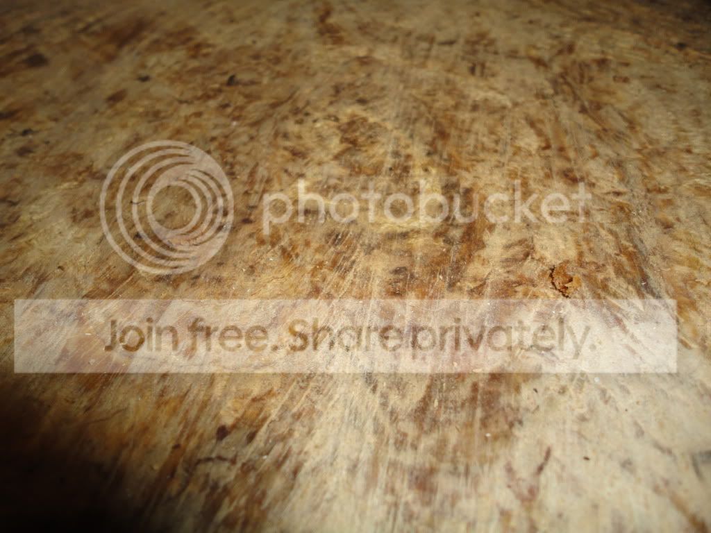

*edit
im keeping it out in the shed, the temp is below 0, thought it would keep it from drying very fast
There are several formulas of Varathane but none are really suitable for use as a moisture barrier on green or wet wood. It's a finish applied to dry wood i.e., floors and furniture and counter tops. You will certainly have adhesion problems. Heavy coats of acrylic base paint or emulsified wax or melted paraffin are proper moisture barriers.
Looks like a lot of bark inclusions and voids to deal with for the high quality cuts needed for most knife makers and the fall down will be high. Wood turners on the other hand can utilize the whole thing.
edit: When I was buying and logging timber on thinning jobs I applied emulsified wax to any inadvertent bark damage to no-cut trees caused by the logging equipment. I believe it sealed off access from bugs and other air borne critters bent on doing damage.

Wax it soon, A bit of beeswax in with the paraffin will make the wax a bit stickier. Hornbeam was used on the sole of some quite famously made historically significant planes (Not the kind you fly , the kind used in woodworking). Very long wearing wood but burns poorly as it burns hot and slow nicely but never really seems to give decent coals and big ones are a bear to split by hand.
