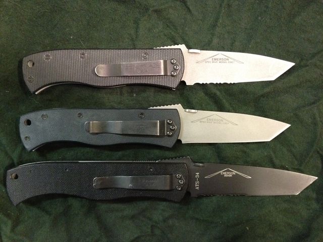

What you have is the Benchmade version of the Emerson CQC-7 I believe. It is not the knife linked, that's a Benchmade Stryker.
It's called the "Benchmade Emerson" maybe? I'm not completely failure with the knife, but I recognize it. They were made in both chisel and symmetrical grind. And were/are a pretty popular knife.
Here is a photo shamelessly stolen from the Internet.
Model is 970; there's also a longer 975.
Don't think they ever made a symmetric grind version?
