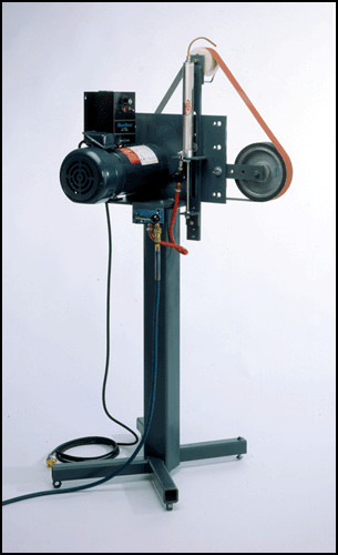

I believe they use big machines that automatically sharpen the knives.
Do they use Gridners like the Dozier Grinder to sharpen knives?
Or are these machines mainly for shaping of the blade and things like that?
whoa! now that's what i'm talking about. What do you think those run? $500K? I tried a quick search in Google, but couldn't find anything on $$$$.
I'm assuming the small/medium companies would use something similar to the Dozier Grinder, since a CNC machine would be WAY out of their price range?
At Benchmade, final sharpening of many models is one of the few processes still done by hand. It's done by a handfull of skilled employees using the sort of equipment that Mr. EkL has shown. They use some simple jigs to help them hold some models, but the sharpening is pretty much a manual affair.
I've never bought one, but just judging from similar sorts of industrial equipment, I'd guess that by the time the machine is delivered, installed, accessorized for your specific application, and you're trained, it's about 250K$.
Such a machine will need a 480V three-phase service (which is part of why it costs less than you might think. The motors are smaller than you might think.) and shop air (which is another part of what keeps the cost below what you might estimate).
