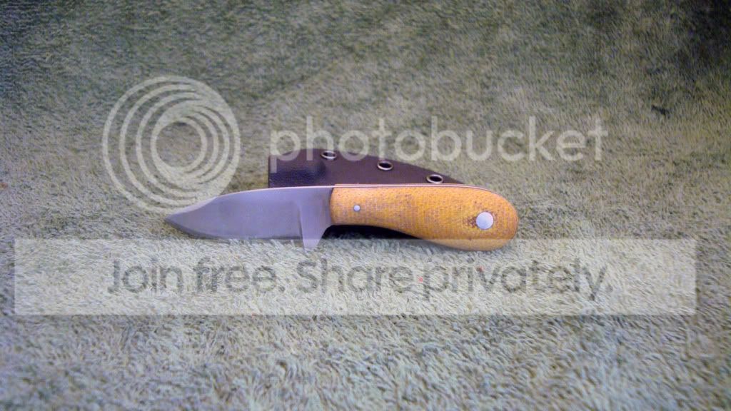

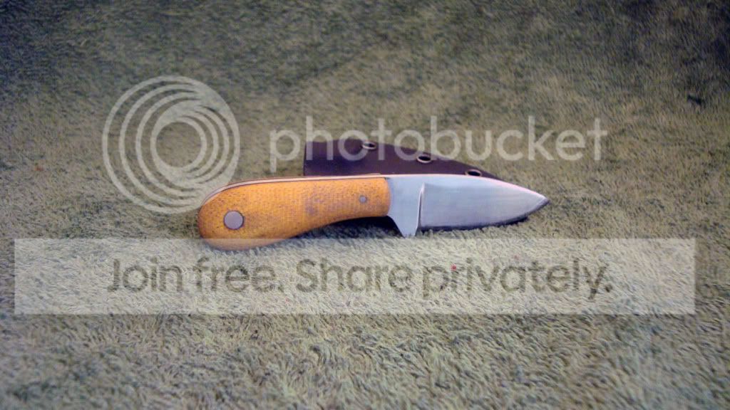

Well for me it was test it out. I grabbed the first piece of steel I could find and went at it. after a little bit of time I had what was looking like a knife in my hands. I refined the shape a bit more, marked out some lines and finished it up and this is what I have today.

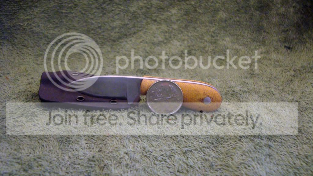

I know its not perfect but it was completely an on the go project and mainly free hand. If you haven't figured it out yet, it is small, OK tiny:D

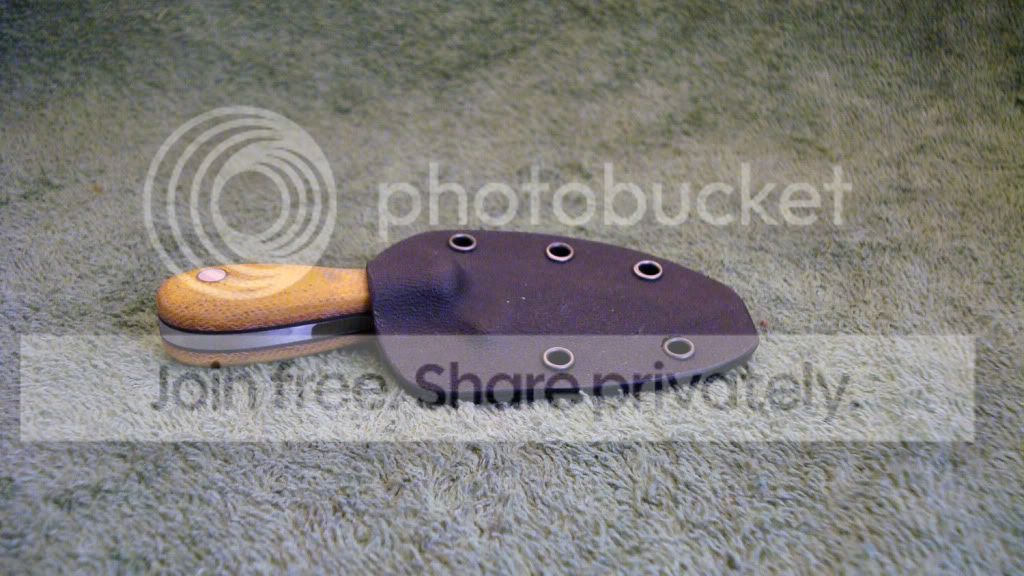

All I had was a small piece of 1084 about 4 1/4" long when I started. Once I realized that I was actually making something I started searching for something to use as scales and pins. I had a couple of scrap pieces of natural linen micarta laying around that I just couldn't bring myself to throw out and a bent piece of 3/16" stainless rod that I actually has put in the waste pile. I combined that with a piece of my over ordering of 1/16" pin stock and I had everything I needed. Even the sheath is a cutoff that was in the scrap pile.
So the knife's specs are:
Overall length: 4"
Blade length: 1.5"
Handle length:2"
Steel: 1/8" 1084
Home HT so I have no idea of what the Rc is, but it skated a new file out of the quench. I think I will call it The Scrapper, because it was made out of scrap:p and it will be going in my tool box at work for opening boxes.

Great looking little user, and I like the name. Looks like a comfy handle.

Nice little utility knife.
What is that handle material?

the Handle is natural linen Micarta.
