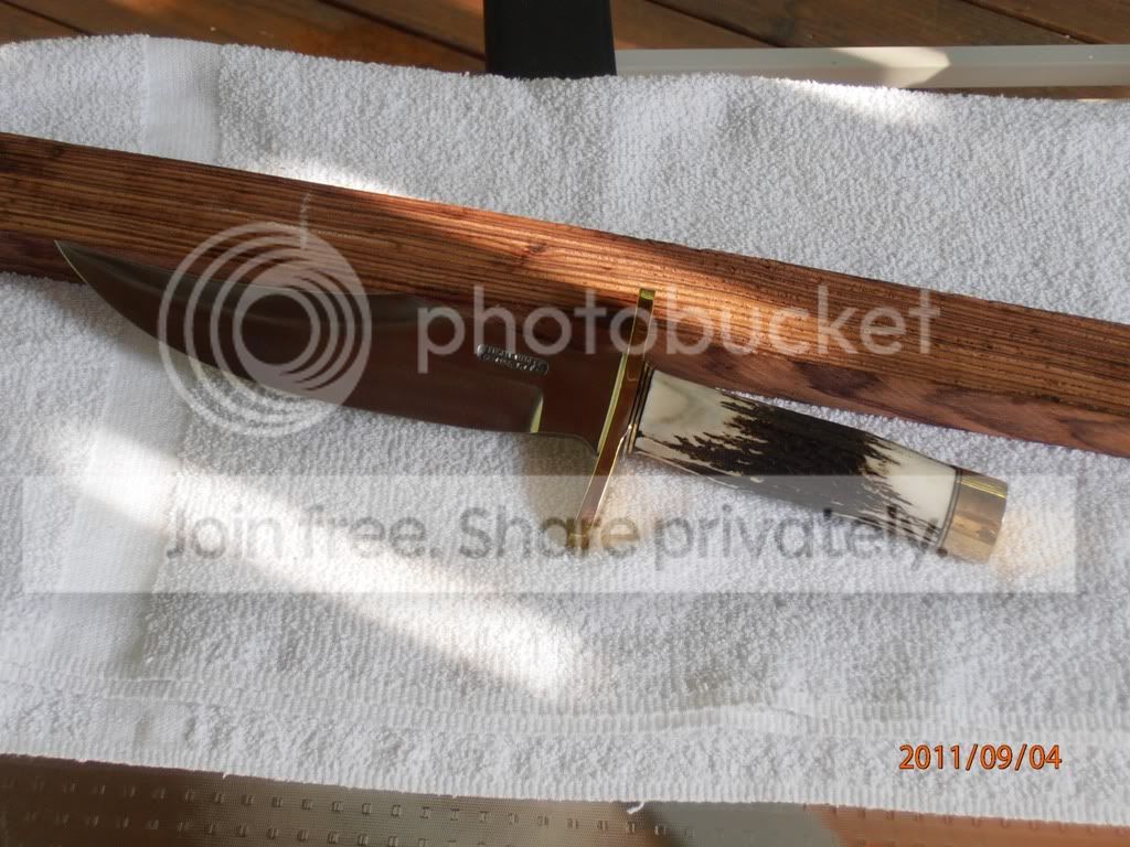

Oh, some things are just worth paying a little "extra" for.:D
(That's an 8" blade — big knife.)
Oh I totally agree. But from a user standpoint, you start hitting a point of diminishing return at about the $150 mark.
Beautiful blade by the way!
