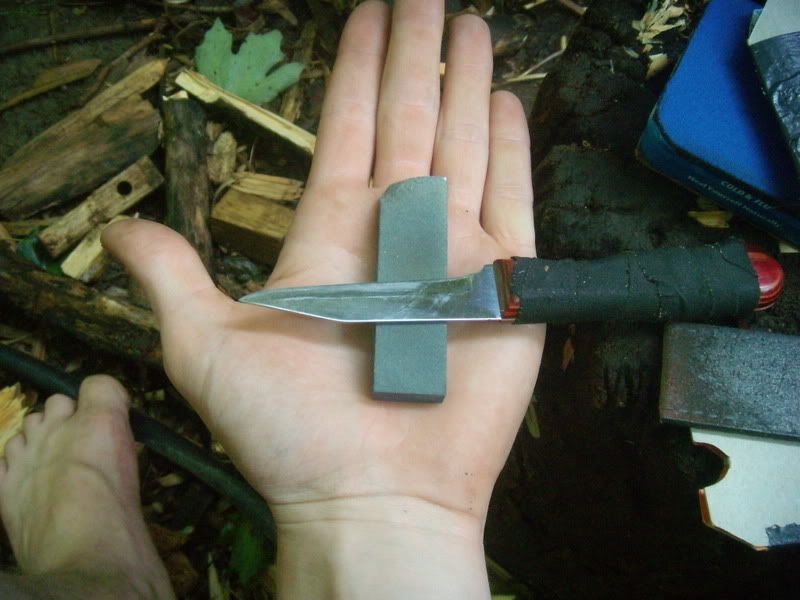

For a large knife, I like a 6" or 8" stone. I said "like" not "need".
If I am free handing, I like a Norton combo stone with a medium Crystolon on one side, Fine India on the other. I use Gunk Thread Cuttling Oil as a lubricant. I find the edge I get from this combination works for me in my everday cutting uses. If I am sharpening prior to edge retention testing, I start that way to rebevel the edge, then finish up on a Spyderco Sharpmaker to guarranty that my edge bevels are all the same angle.
But there are lots of ways to sharpen and there are lots of folks here that are way better at sharpening than I.

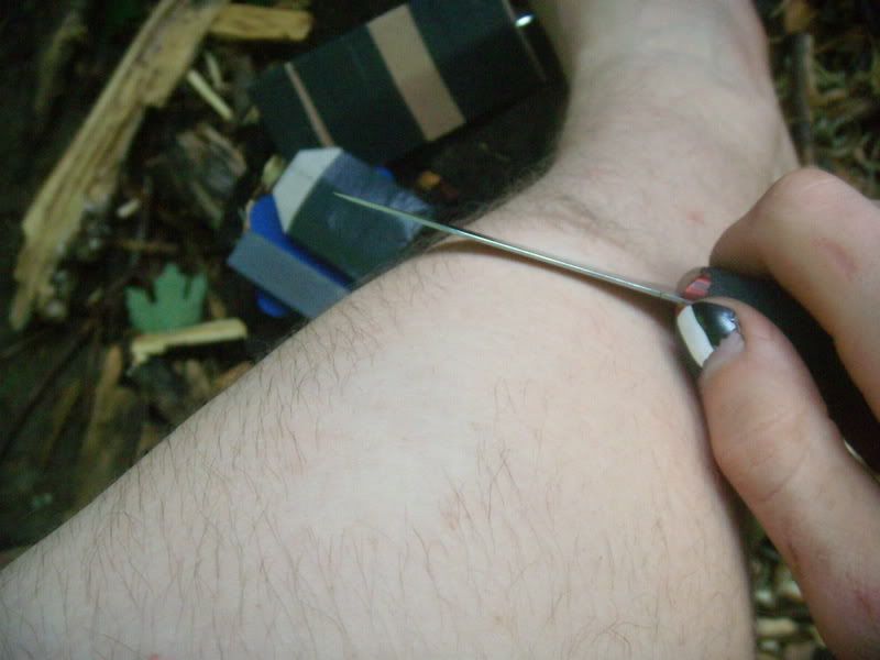

all i need are a small pocket stone and a loaded strop. with some practice, that's all you will need too
this was sharpened right after having been thrown blade-first into my pal's lawn. he thought it was a good idea, and i didn't realize what his intentions were until too late...oh well its just a beater.
