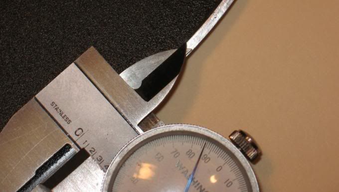

I just measured my Cara Cara, which I did a slight reprofile with the sharpmaker using a rod as a teeter totter to decrease the sharpening angle. It really wasn't much of a change from the factory angle as it went extremely quick on the diamond rods. Edge Thickness was .025", with an angle of 10.5 degrees (using trig to figure the angle, turns out close to what I thought it was). My R2 was sent off to Ben Dale to sharpen, he said he slightly reprofiled it at the 17 degree setting on the edge pro, which seemed way obtuse compared to what I thought it was, as 15 degrees was only microbeveling the factory angle, but the edge pro doesn't account for the flat grind angle of the whole blade. Edge thickness is .018-.019 at the top of the bevel, with an angle around 11 degrees (again using trig). Looks like I need to flatten that out to the 8 degree range. I will try to measure my reprofiled Jess Horn and get back with the measurements. The angle measurements could be a lot more accurate, as I'm just doing my best to eyeball the hypotnuse as best I can with the calipers next to the bevel, but the angles seem in line with what I thought they were. Any other suggestions for more accurate measurements of the angles without expensive equipment?
I don't know if this is the way you're doing it, gunmike, but I find it easier and much more accurate to use the inside diameter "jaws" of a caliper as shown here:
Thickness behind edge is actually where I'm more likely to screw up. It's kind of an awkward two-handed proposition, making sure I'm measuring right at the back of the bevel and keeping the caliper perpendicular to the blade; a little wiggling as you work the adjustment on the caliper helps.
The above blade I sharpened to about 12 degrees per side. Thickness is .034" behind the edge, with the bevel .086" wide. This works out to about 11.4 degrees/side ( inverse sine of (.034/2)/.086 ) .... probably fair to say I eyeballed this one very favorably :) but generally you should get pretty close.
If the andle width or thickness is really small it will be next to impossible to measure the angles directly to anything but a coarse estimate. You can usually get a better measurement by doing the trig of the angle the blade makes with the sharpening stone.
That's exactly how I did it. Both of the knives I measured have very distinct edge bevels, where my Jess Horn and Endura Wave have horribly smeared primary grinds from pounding away on the DMT X coarse. Cliff's method of using the trig off of the stone will be the best way to get the angle on those.

If the bevel isn't distinct then just use a marker to create a point of reference and measure to that. Check several points along the blade to determine the deviation.
