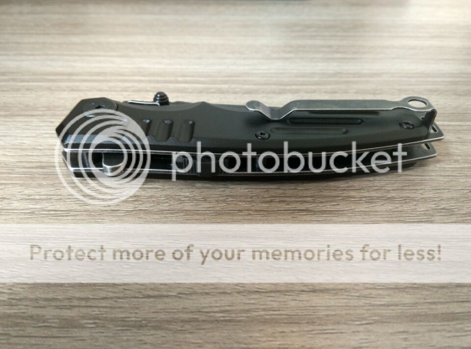

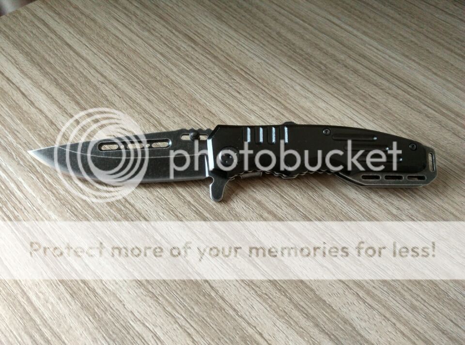

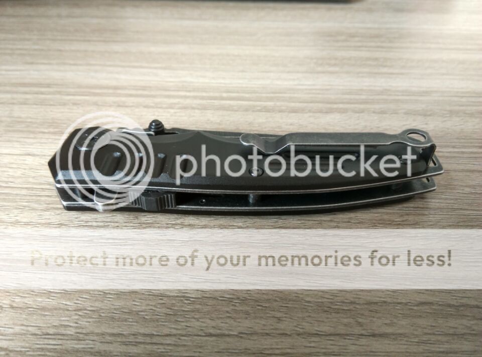

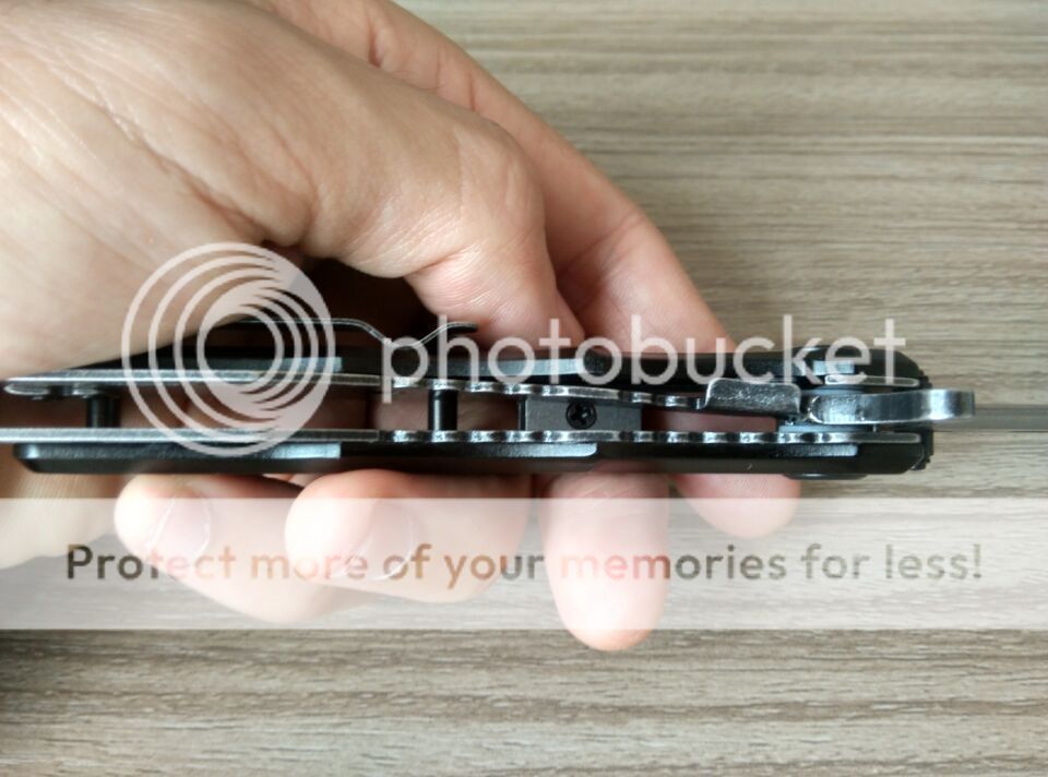

what do you think of this kind of lock mechanism on knives
Apr 13, 2012
37
there is a switch on the back of the knife,the button need to be pulled forward near the flipper when closed and the blade is locked,on the contrary,the botton need to be pulled back when opened.the blade is released.
1.blade locked
2.blade released
3.spring assisted
Looks like a SOG Salute or Mini Salute with a flipper and a different locking mechanism. While I have seen other knives with safety buttons/tabs/locks, I don't personally get the point of such a feature. Just one more moving part to potentially break, and not necessary for most knife users, plus it looks like it would be a hassle to slide the safety tab with the middle finger.
yes,i guess so,it's like the sog knife.the locking mechanism really need to be improved,because it is not that smooth when pulled back or forward.anyway,it's safter with a lock like that to a spring assisted knife.

I understand that some knife designers feel compelled to include more safety features, but I personally carry a knife every day, and none of my assisted-opening knives has ever opened accidentally in my pocket. Likewise, I've never been in a situation where a knife's primary locking mechanism (liner, frame, etc.) failed and would have depended on a secondary lock to stay in place. In fact, the only folding knife that has ever "broken" on me so far was a Smith & Wesson Extreme Ops folder that fell apart right at the pivot, where a secondary lock would not have helped.
I'm sure that there are some people who might benefit from such a feature, but the pictured lock design looks poorly located. Yes, it prevents the flipper from moving far enough to engage unexpectedly, but it would be more intuitive to place it where it could be activated either by the thumb or index finger, possibly set into the scale or liner. The CRKT "LAWKS" system, for example, is pretty unobtrusive when opening or closing a knife, but is located for easy access as part of the knife's normal operation.
