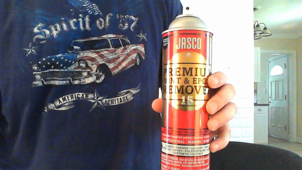

Hey all! Just got some new silver split arrows in the mail courtesy of Benchmade! They replaced the basic clips that come on Griptilians. Now what I want to know is what stripper do I use to strip the paint off of the old ones? Id like to strip off the paint and polish them. I read somewhere that Jasco Premium Paint and Epoxy Remover will have my clips totally stripped and clear of any paint in just a few minutes. Before I run off to Home Depot I wanted to get a couple more opinions. Any help would be awesome

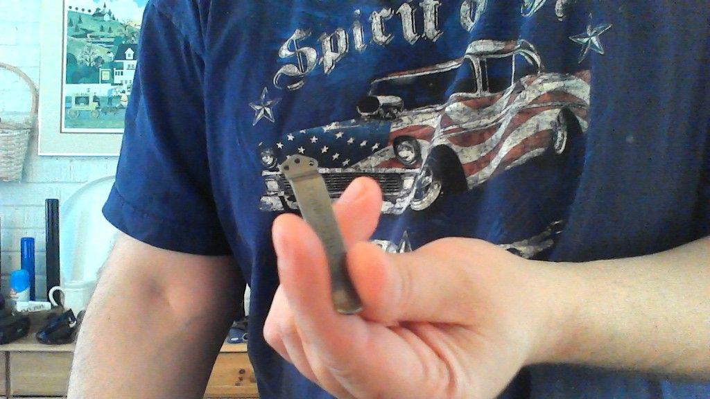

Alright! Jasco Premium Paint and Epoxy Remover plus steel wool equals a nice unpainted steel Benchmade clip!!!

I think that turned out quite well!I am a big fan of fine steel wool for polishing too.
