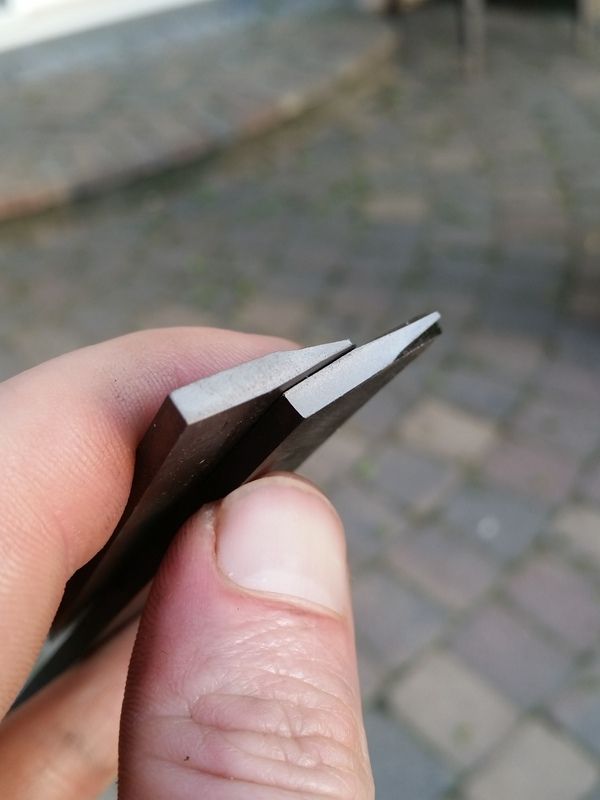

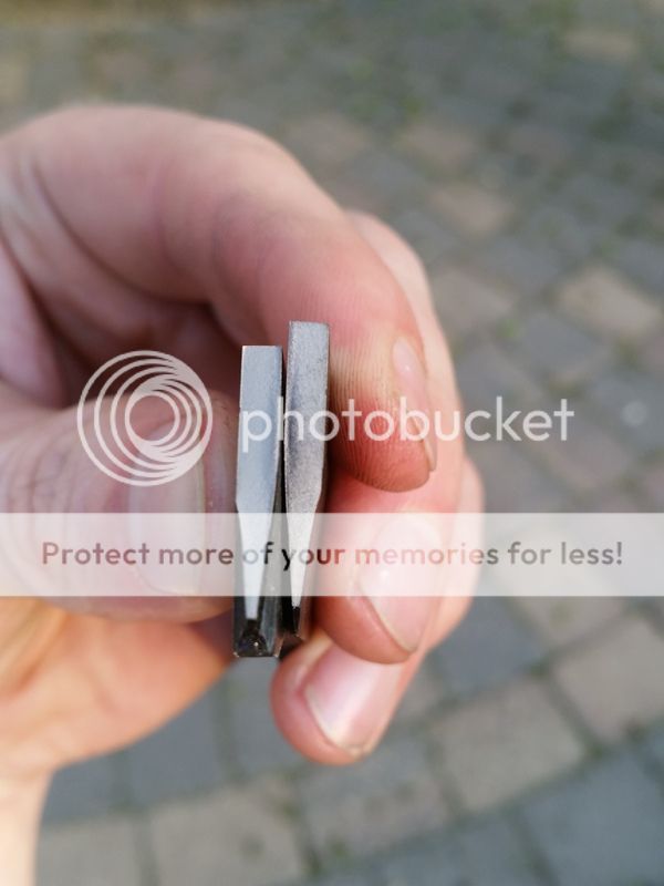

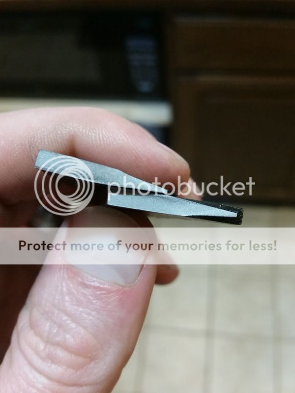

One thing I always hear guys talk about is if steel xyz has "good grain". While I understand the concept, what I don't quite understand is what good grain looks like and what bad grain looks like. I recently broke a blade trying to straighten it after heat treat. The blade is O1, I now know that O1 is a more difficult choice for a simple setup and have switched to 1084, but I'm trying to learn from what I've done. Below are the best pictures I could get of the broken blade. is this grain "good" or "bad"? thanks fellas.
Yes, that looks good. Good grain is fine grain. It should look frosty and like broken cement. If it looks granular, like sugar, the grain has grown a bit larger. If it looks geometric, like stacked small blocks, then the grain is huge.
Break and old file for a comparison of what very fine grain looks like.

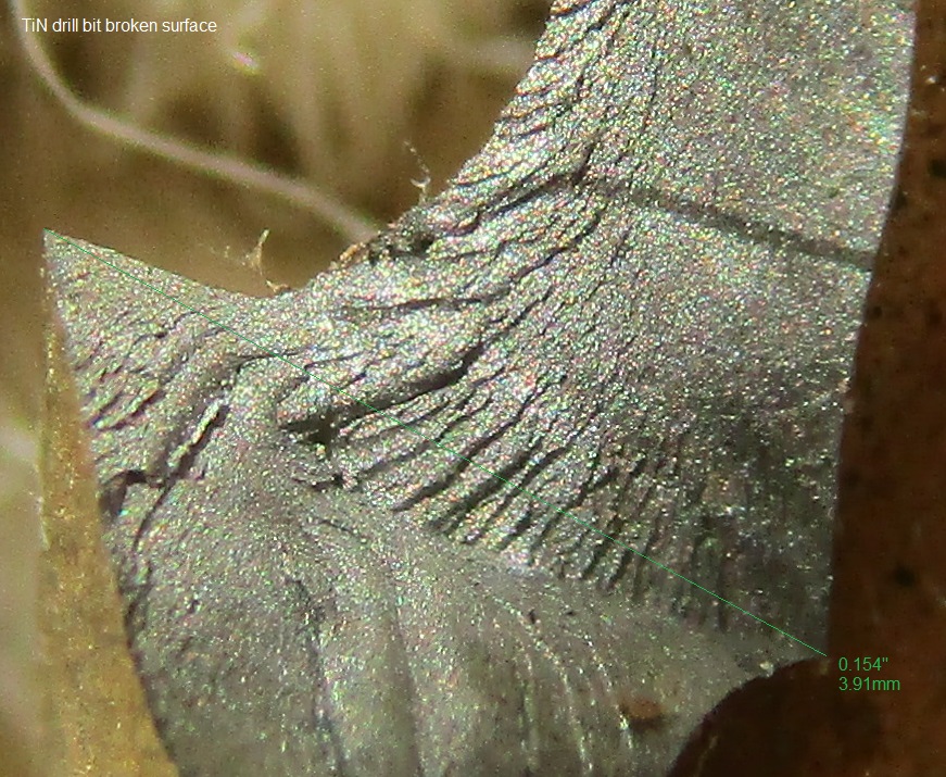

Most likely your O1 grain size is fine/small. It's a clean/cleavage break, which doesn't reveal much topological details to read/guess grain size or microstructure. I concur with Stacy's statement on macro view of broken surface. Here is TiN (coated) drillbit fractured surface camera macro+15x Peak loupe (one way convex len, unlike common symmetrical convex lens loupe which negate/reduce/cancel camera macro)
Clean/cleavage break implies intergranular fracture, which is much easier/weaker than fiberous/irregular/trenches/etc surface. Smallest feature you can detect/see, likely to be a cluster of grain. Trenches/lines are fracture pathways, degree of meandering = corresponding to degree of strength & toughness.
The finer the grain the harder to discern grain boundary(gb) at as-quenched, temper blur/hide gb even more. I think, best read/detect would be using BSED(back scatter electron diffraction) at fracture surface (instead of polished + etched surface). I have 3 diff polished+etched samples, where BSED at 50K & 100K (magnification) failed to detect gb.
