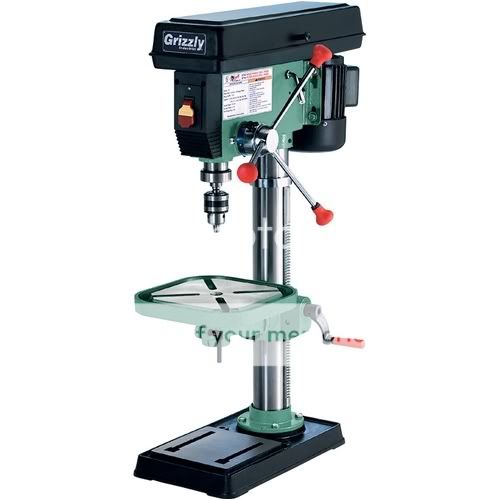

I've been searching for a drill press and found the G7943 12 Speed Heavy-Duty Bench I like what I see as speed ranges and motor size. But I was wondering what everyone is using or would recommend. Sometimes I feel like buying a cheap drill press like a used one on craigslist or a harbor freight one. But I have wasted alot of time and money on cheap tools.
Thanks In advance.
Tod
# Motor: 3/4 HP, 110V
# Overall height: 38"
# Spindle travel: 3-1/4"
# Number of speeds: 12
# Drill chuck: 1/8" - 5/8"
# Spindle taper: MT #2
# Range of speeds: 140, 260, 320, 380, 480, 540, 980, 1160, 1510, 1650, 2180, 3050 RPM

HF 1.5hp 12-speed (#39955) for past 3-years. BIG and cheap. Table could be better. Not exactly like the one shown in the picture. Since mine, the handles have changed from steel with yellow nobs to the goofy plastic starfish shown.

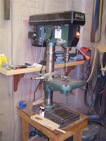

I've been using that Grizzly for 4 or so years Datsun, and have no complaints. I chose it because of the bench models I saw it had the thickest post, and the heaviest motor. The time has come for me to get a hand chuck for it though. Other than that, no complaints at all. I had a harbor freight before this and the motor blew after 6 weeks.

Datsun My HF DP looks exactly like that Grizzly but has
1/2 Hp, not 3/4 250-3350 RPM's JT-2
I took it to MTT class and checked the run-out.
My dial indicator has .0005 index.
The arbor by itself had a run out of about .0020
The needle did not reach 0.0020, it's probably about 0.0018
I chucked up a precision dowel and the chuck's run-out
was alittle under 0.0035.
I think for an 89.99 Drill press that's not too bad.
