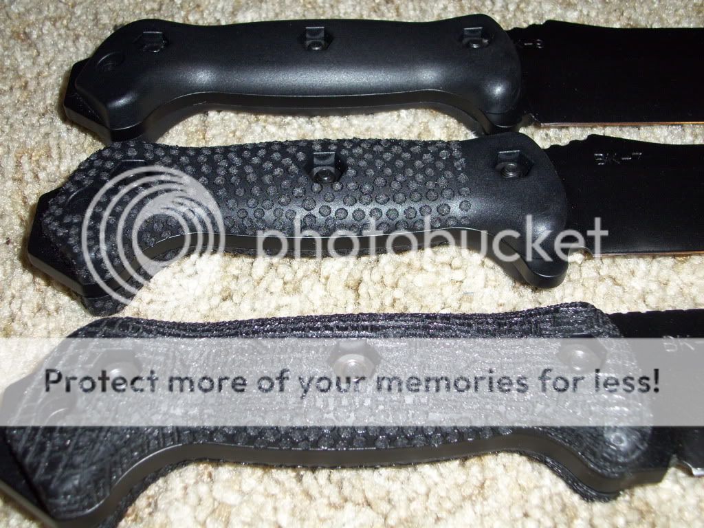

Well, as some of you know, I like to make custom wood handles for my Beckers. Most handles I see on the market are little more than 2D slabs with rounded edges. I've been experimenting with finger grooves and other texturing to improve comfort and grip. Here's my question. What types of knife would you like to have texturing on? What types would you prefer to have smooth. How well do you want your fingers locked in place?
Here's some examples:
Captain Airyica's BK11 handle, with finger grooves:
Here's a custom EDC knife that I made myself out of 1095 steel, FFG, with both finger grooves and file texturing:
Here's a couple smoother handles:
My thoughts are thusly: For an EDC, I like to make sure my fingers are locked in place and have some texture to promote grip. But for a chopper, it seems that might be bad, because it might promote chafing. So I think file texturing is certainly out, but I just don't know about finger grooves. I'd like to get some input from my more woodsy brethren and sisters as to what kind of handles they prefer, and maybe get some mods going that think a bit more outside the box than the generic rounded edges.
