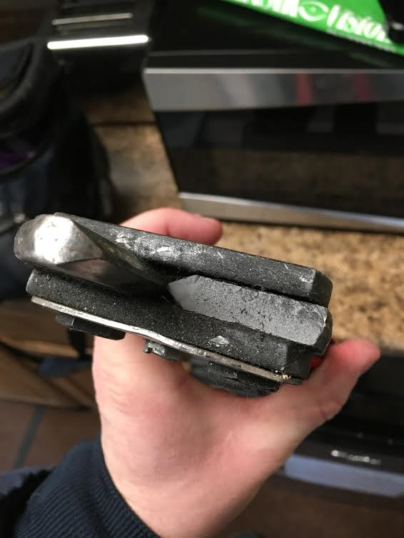

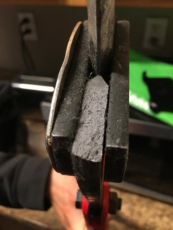

Not a knife blade but I'm curious what might be going on with this bolt cutting blade. This set of bolt cutters is made by H.K. Porter and is used daily commercially to cut 25-100 bolts off of containers at a dock per day. They were several years old when they failed. I noticed the inside of the blades grain looks uneven. Looks very "tight and small" at the cutting side and seems to get larger towards the back. Just wondering if the steel experts might be able to tell what is going on here? Enjoy!
Forged blade like that is probably only edge quenched, or induction hardened or some other method that only partially hardened it. Likely over years of use a small stress crack started in the hardened portion and simply propagated unnoticed as a weak point until it was one bolt too many.

I agree, that cutting edge hardened higher than the rest of the jaw, cracked, then propagated. Whatever, you got your moneys worth cutting thousands in its lifetime.

Thanks guys! So the larger looking grain behind the edge is softer? How exactly are blades like this forged? A big machine pound them out? I would think they heat treat and temper hundreds of blades at the same time. I would guess because of this the blade would be one hardness. I saw an episode of "How it's made" and they wee making saw blades and it looked like they were heating hundreds of them on a conveyor belt and then they dropped them into a quench before tempering in a oven.

It is called metal fatigue. It starts when a stress is applied. The leverage of the cutters is enough to apply stress. Twisting adds more stress. As the cutters get dulled, the amount of stress greatly increases as there is more force applied to do the same cut. Little stress cracks start forming ( the lines up from the side) as the grain boundaries start to fail. Then one crack starts moving down the grain boundaries and a fatal crack forms. All the stress will now run down this path and break the blade from side to side.

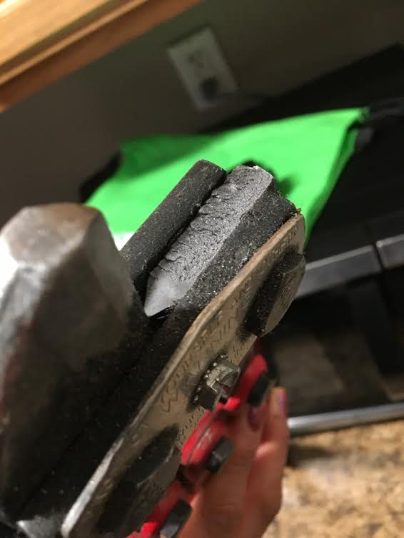

So are the stress cracks those "feather" looking spots on the left-hand side of the bottom picture? Any guesses on what steel this might be made out of? I have a few of the old blades and was thinking it would make a great knife. The stuff obviously a super durable.
Yes, the "feathers" are where the stress cracks started. Because they are pulling away from one side only, I suspect the bolt cutters were being twisted or laterally pulled when they broke.
No telling what the steel is. It may not even be a steel that would forge into a blade well. You could try contacting the maker and ask them what steel they use. Unless there is some great sentimental attachment to the cutters, buying a new bar of 1095, W2, or whatever steel you like would be far wiser.
As far as hardening, I think the cutter edge is harder than the body. You can see it in the different texture where its broken.
In manufacturing that sort of differential hardening is common. Probably done by induction but maybe a fast torch passthru.
That may have started out as a crack on the leading edge , developing into a fatigue failure [smooth area] then final failure .A better photo might help with the answer.

Danke's photo , on the left side , shows a secondary fatigue failure !
