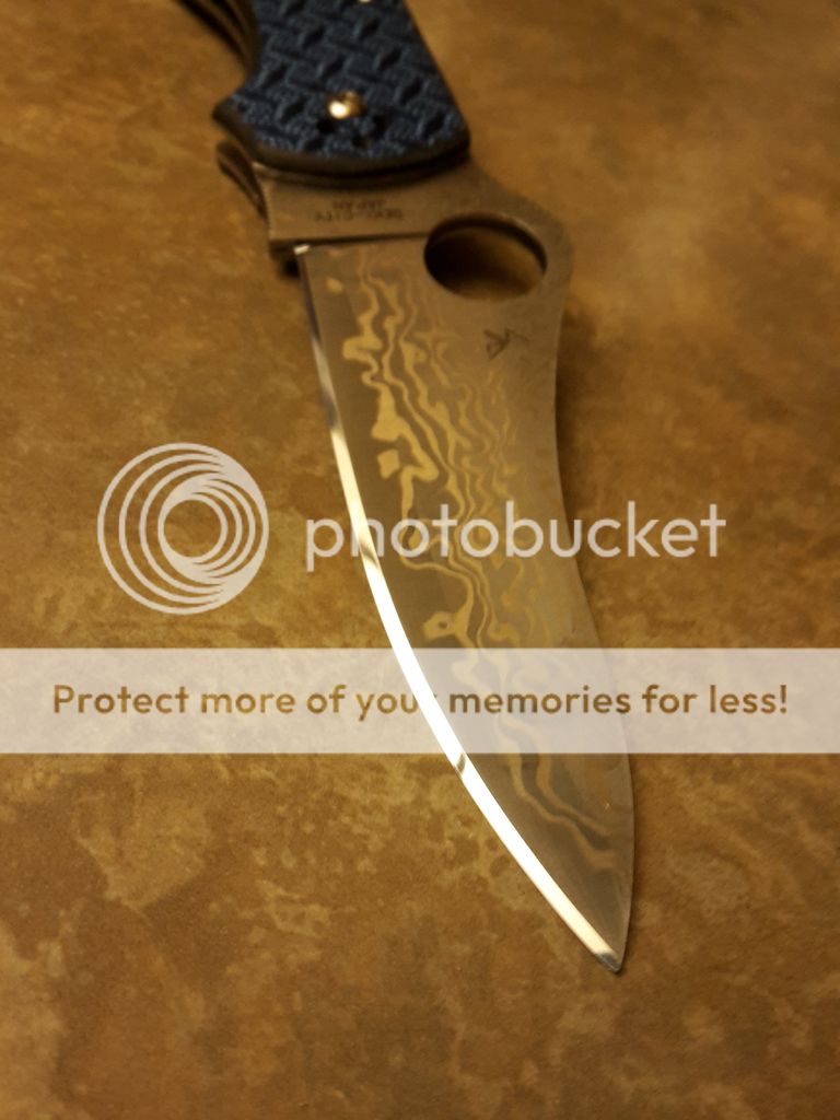

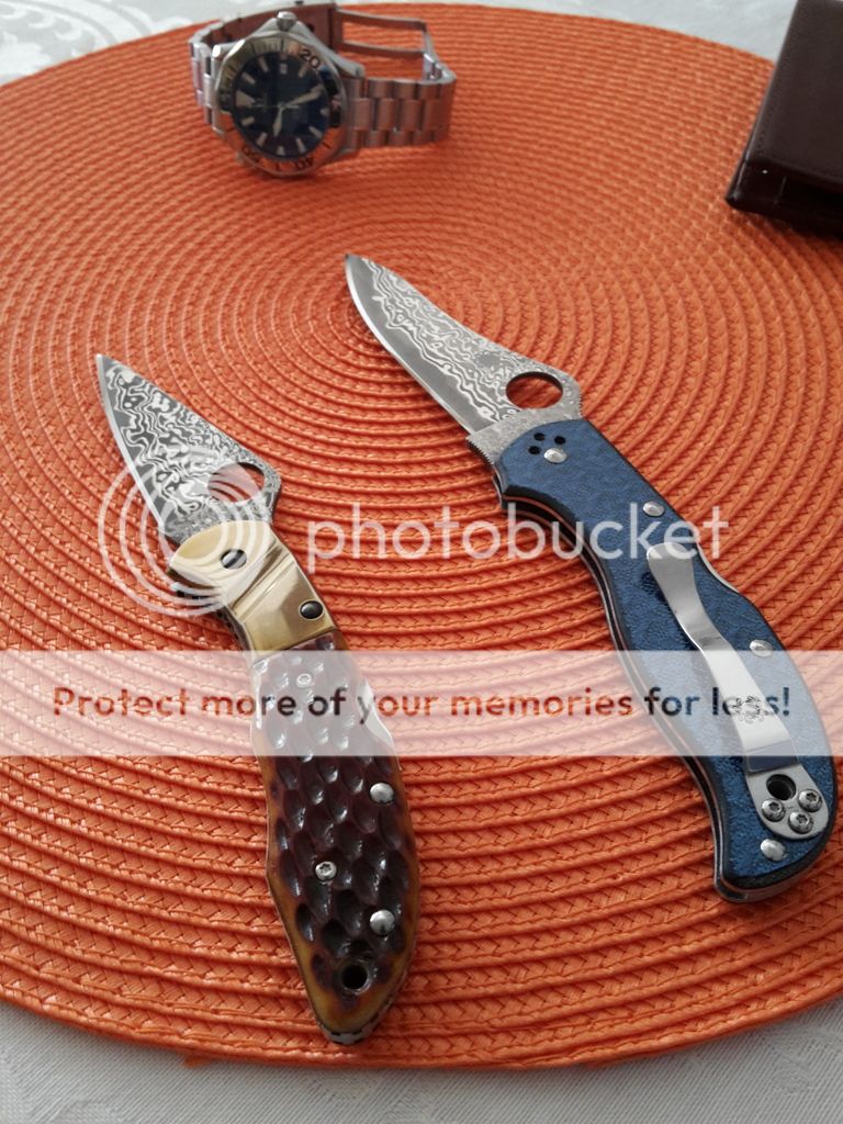

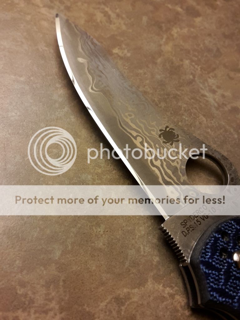

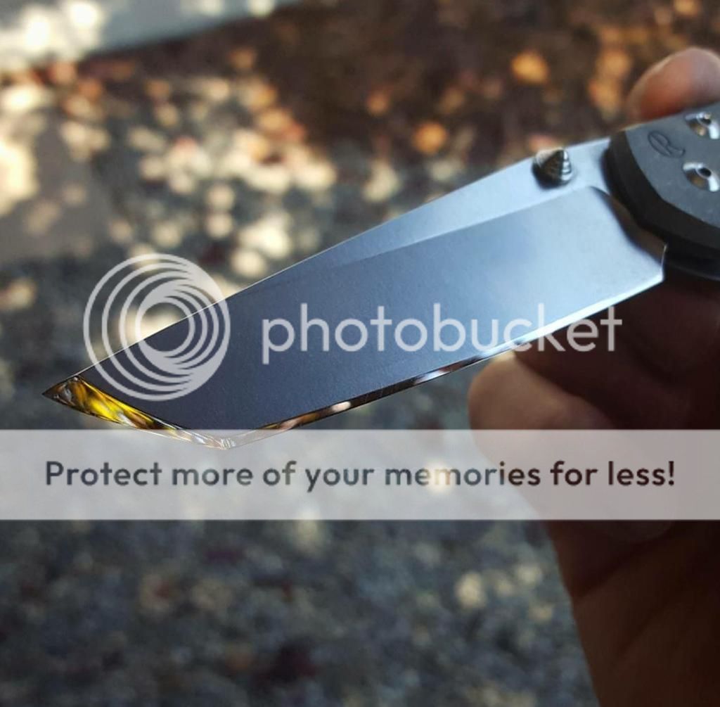

I have attached 4 pics
3 are of Spydercos that i have sharpened without any problem and another of a CRK tanto notice how it is perfect where the tanto and main edge meet. What am i doing wrong? And what do i need to do to accomplish this?
