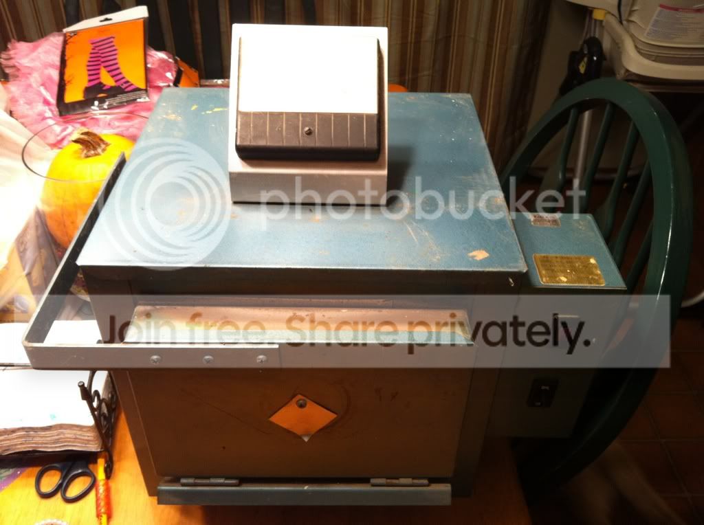

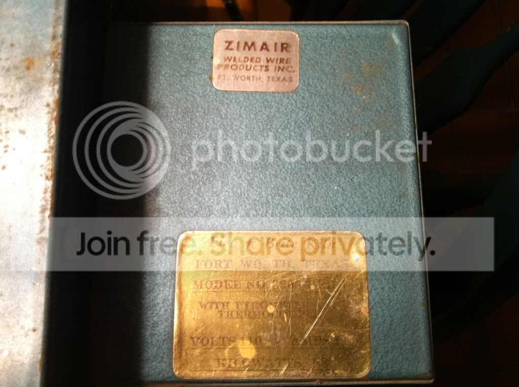

Got this when I moved. Looks to be in good shape. Says Fire Brite kiln and I know it was used for pottery. Does anyone know anything more about this kiln or how well suited it will be for knifemaking.
Google didn't help.
Thanks
Brian
Not sure exactly what it started life as, small pottery kiln, heat treat oven, etc, but I would definatly get a digital pyrometer to make sure you know the exact temperatures it puts out and use it as a heat treating oven.
-Adam

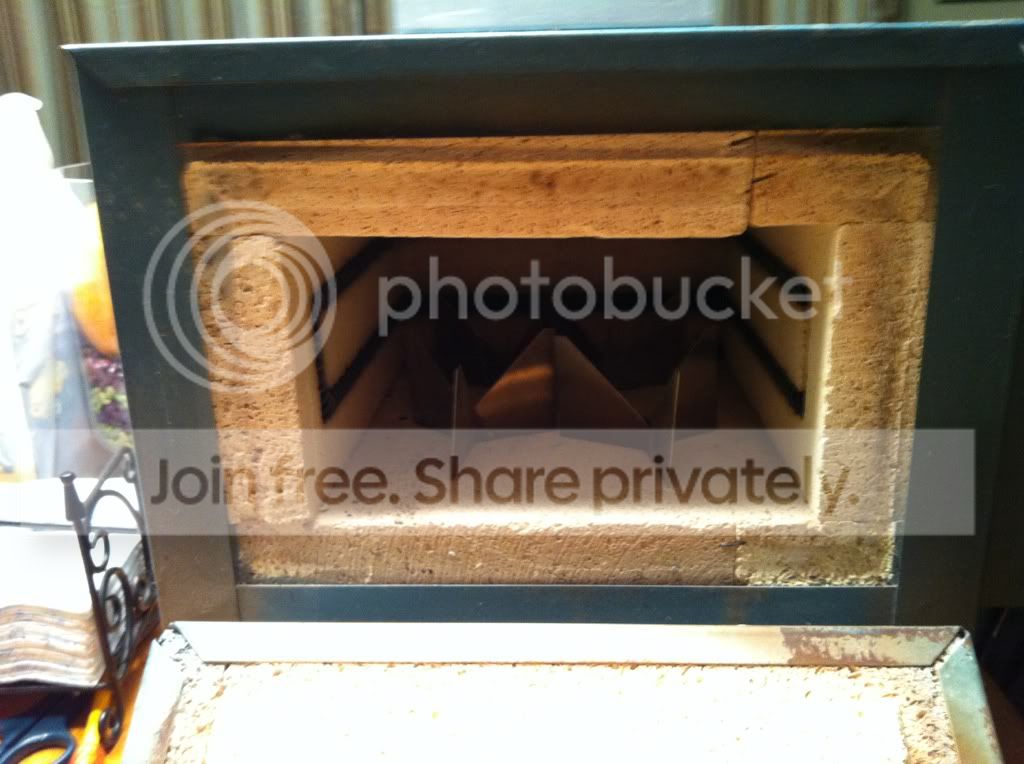

We do enamel work in small electric kilns like that. We are using one now in our high school jewelry making classes. We've rigged a heavier counter weight on the door handle to the left to help hold the door closed snug. Ours has the same little swing aside peephole in the door. Looks like your pyrometer is sitting over the exhaust port on top. It looks like yours might just have on/off switching though? Ours has an adjustable temperature dial (for what it's worth.) We use stainless steel trivets that look just about like those inside yours too to stand the enameled copper pieces up off the floor. I understand metal clays for jewelry making are quite popular these days, which would likely be fired in something like that.
I've used a jeweler's burnout oven (with what looks like to be a bit larger inner chamber) for heat treating small blades. Seems like that could do for small stuff.
What Phil said.

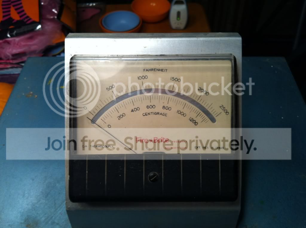

Adding a PID control to that will be easy, as you just add a few components in the existing control box. All you will need are a PID, and SSR and heat sink, and a TC and sheath.
It will work fine for small size blades of carbon steel. Those units aren't good for much above 1700-1800F. I know the scale shows 2500F, but my car speedometer shows 120 MPH,too.
