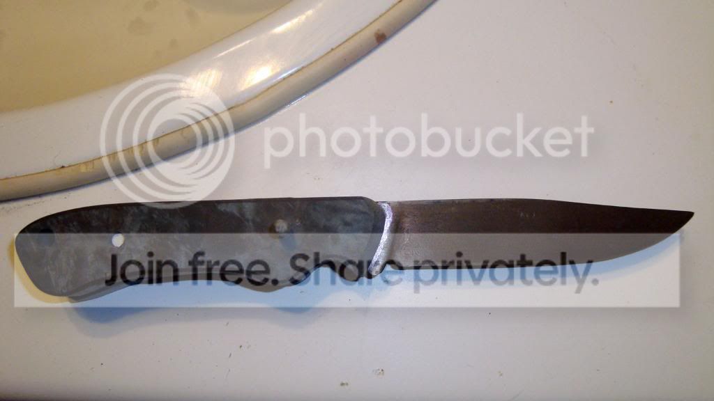

So its been awhile since I have completed a knife:o and I still haven't finished one, but I am getting closer:D
I got 3 back from Knifemaker.ca yesterday and I started sanding last night, but I let my paper supplies slip and ran out of 400 grit before I finished getting rid of the previous scratches. So with nothing else I could to do I cut out the scales for two of the knives and did some rough shaping.

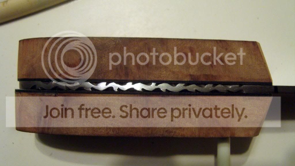

My revisit of the little EDC was supposed to have natural canvas micarta scales, but me being without a working drill press I has someone else drill them out for me, well they didn't follow my instructions of how to drill them so they don't line up right on the handle. I made a quick change to some redwood burl I had won in a contest that marekz had some time ago. Well Farmer Phil actually won, but he donated it to me:p, so that is the new scales for the EDC with the file work.
Ignore the marker by the plunge line it was just there to help line up the scales while drilling. I have a lot of shaping to do and almost all of the finish sanding, but hope to be finished this one by Monday night. I have Christmas parties to go to tomorrow:(

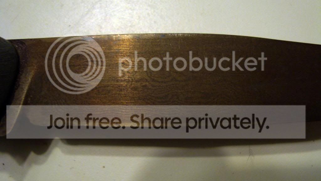

The other one I will be working on this weekend is the Damascus that I got from Dan Seaver, it is going to have stabilized blue dyed birch burl scales that I bought just after getting the steel from Dan. I am hoping to get this one finished sometime by the end of next week. I still need to buy my Ferric Chloride and make a tank so that is what is going to set me back a bit. I am also hoping my stencils will be in by the end of the week so I can actually put my mark on these before they are used.
Its looking kind of reddish because of the incandescent lights where I took the picture, but I like how the pattern is already showing. Once I get my Ferric Chloride and I know what strength it is I am sure I will be asking what ratio to use to get a nice dark etch.

4:1 is what I have used and what I have read most use. Good start so far, at least you are getting some time in. I know what you mean with lack of supplies- I'm out of everything under 600 right now. Still sore from your injury?
I can sand for about 60-90 minutes then I have to take a break, so I go in 45 minute intervals. I figure if I stop before it hurts I am not doing any harm.
I am not sure how pure the Ferric Chloride I can get is and they don't say on the web site so I will have to wait till I go to the store to buy it. I figure I don't need to buy the 4L jug of it and can get away with only a liter.

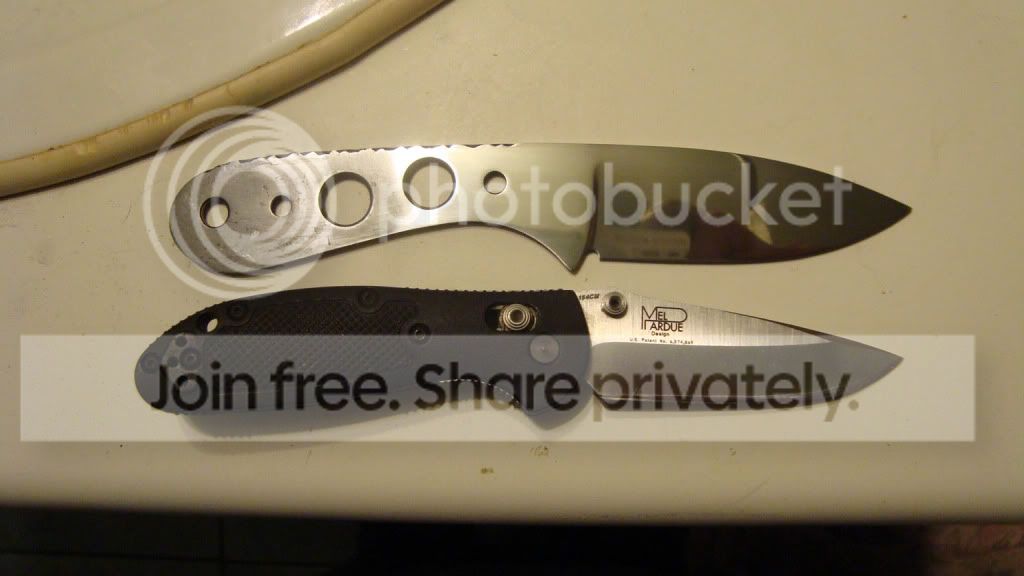

you want a real laugh, next time I take a picture I will put it up against my 556 mini grip, I think we may have to start calling it the Mel Pardue knife:eek: I had never even noticed it till tonight when I was using the mini grip to cut some leather I jut happened to lay it down beside the one I am working on
DOH!!!:o Looks like we're both design pirates!!:D

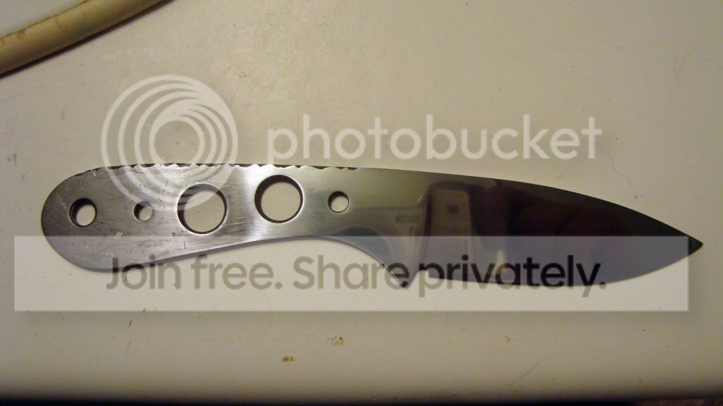

Now that its getting some shine to it it doesn't quite look as similar:o but the blade and cutting edge are exactly the same length and handle shape is close, just rounder at the end. I still have 4 small scratches to get out on this side, but its late and I have a full day for parties to go to. Time for this wannabe to hit the sack

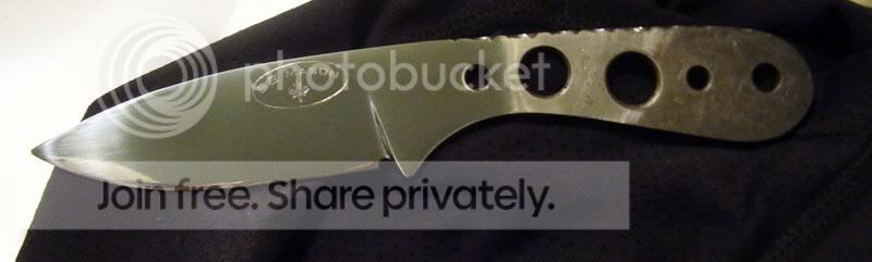

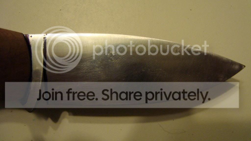

Well I finished the polish on the EDC and the makers mark is on it. I decided not to blacken it, I just liked the look of the shiny mark on the polished blade. Tomorrow I will be attaching that scales and Thursday I will start shaping them.

Wow, that looks fantastic! How did you do your maker's mark?
I had some stencils made up by Ernie Grospitch, then use a basic salt water vinegar mixture, a car battery charge and a etching pad I made with some felt a piece of wood and some copper pipe I split and bent over the pipe. I actually burned up one stencil practicing so that I would get it right on the blade.

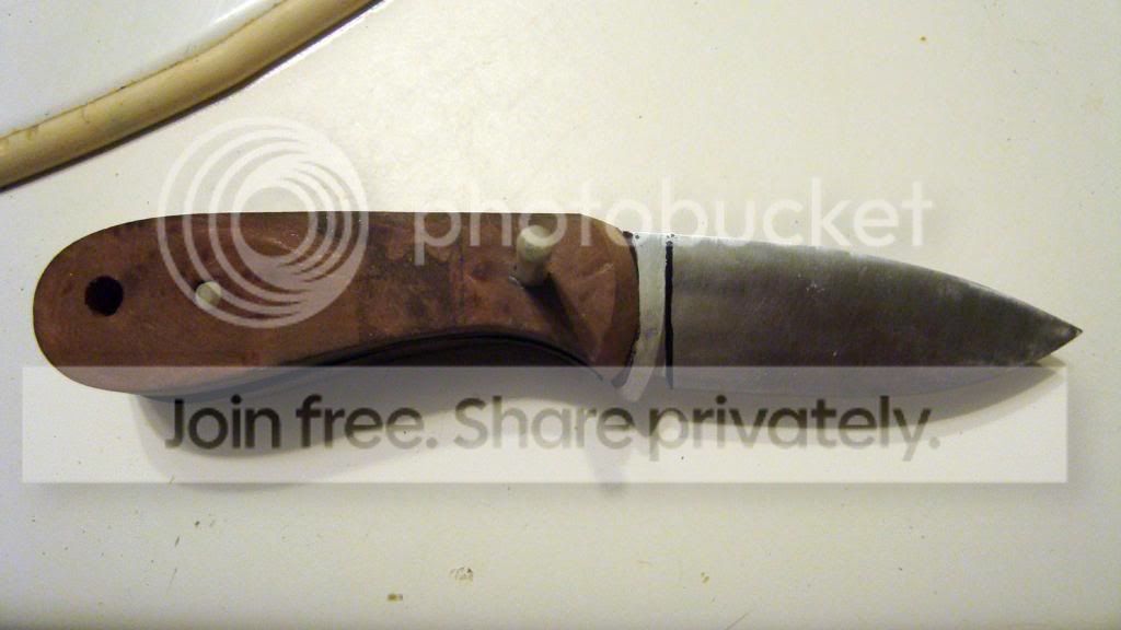

Thanks both of you, I am really liking how this one is looking right now. I epoxied the scales on this evening after bringing the fronts to finished levels and some rough shaping so I can switch over to sandpaper to finish shaping. The epoxy I used takes 24 hours to set so I may be waiting till Friday morning to get back to finishing that one. The redwood has decent figure, but when I tong oil it I will see what I really have.
