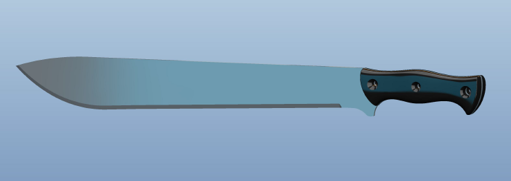

Also I have the big CNC machete run that will be ready this this spring. There will be tons of variations and blade shapes. A little something for everyone. They will be made from the new Nitro-V AEBL, 52100, and as long as I can get the stock size thin enough S7. May do a couple in 3V just to try it.
This CNC handle will also be used on the Liberator Bolo which will be getting a new run this spring as well. The new ones will be 52100 and 3V and hopefully Nitro-V AEBL if they have it in stock. This design has really grown on me and I'd like to get more of these out there.

New Bowie design that will be cut for the spring run. It will have the same CNC handle that is featured on the fell beast machetes and liberator Bolo.
Its a big, heavy chopper that should be a monster on hardwoods. 13.5 inch blade that reaches slightly over 2.5 inches at the widest point. I put some extra belly on the blade for increased forward weight and chopping power. Steel will be 52100 and 3V. Looking at .250- stock with a full flat grind and skeleton tang for weight reduction.

I love that design. Can you show a CAD of it next to the Liberator, as they're a similar size? You're coming up with some awesome ideas this year.

Also, fwiw, on the kukri, I love the shape, I would just straighten it out a bit to reduce the recurve a bit (for ease of sharpening), and also to give the blade some nice general capabilities (instead of just being a hard hitting chopper with that really significant drop).

I haven't finalized the Kukri design or specs yet. Its a design that I will need to do some pretty serious testing with before I make a run. With that said, I will be cutting out 2-3 of these for the spring run in pretty much the current iteration. Ill probably keep one for testing and finish the other 2 for customers. Steel will be 3/8th 80CRV2 for the test models. 80CRV2 is a solid performer and its inexpensive and easy for me to grind. Once the design is tested and 100% finalized Ill make them from CPM 3V and or L6
They're going to be a handful in 3/8s. I have a similar sized one in 5/16ths S7. Incredible heavy duty chopper, but a handful for anything else. That's not bad or good...just depends on what you want.
For a while I was very much so into the 5/16-3/8", 13+" blades, but I've dialed it back a bit. I find those thicknesses ok if there is distal taper, but otherwise they get very heavy quick for anything but heavy chopping, and with the link and width you are already getting heavily increased chopping power. I prefer now to then leave them a little more balanced so they can be used for limbing and other things with more ease.

I'm almost certain I'll surface grind down the stock after I get a general feel for the weight of the blank. I'm guessing it will end up in the .300 range. Unfortunately there's not a lot of stock out there in that size so I have to start big and work down. 3/8th steel is really overkill for anything but an axe or hawk. My breaching Hawk blanks weight over 3 lbs before the tapering process :eek:
No matter where the stock thickness ends up I'm going to make sure that the Kukri is a functional and versatile blade that is more than just a sledge hammer with an edge that we see all too often in the knife world. My blades are all heavily Americanized but I always try to stay true to the spirit of the blade shape. The Nepalese have spent hundreds of years refining the Kukri and I hope to make one that honors those countless years of trial and error.
I'm also always open to making versions with different stock sizes. As long as the handle and blade shape stay the same changing stock thickness is usually no problem at all. I could make a heavy hitter version and a lighter snappier version from something closer to the .250 range
