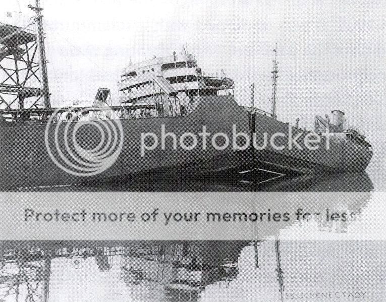

Search " BrittleTransition Temperature" of steel. Composition, grain size, etc all play a part. In the 1900s this subject was studied thoroughly. You worry about your little knife breaking !! See if you can find a photo of a WWII Liberty ship broke in half !
Yup, that could ruin your whole day.
