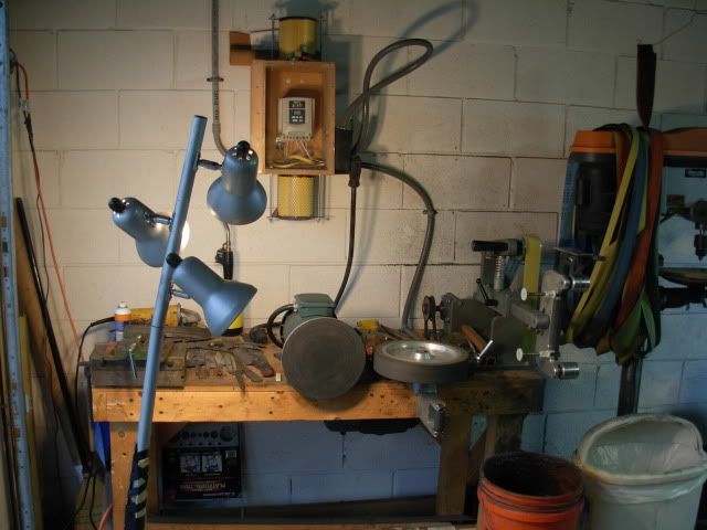

Here's what I did with my setup. I currently run a disc grinder, KMG, and another 2x72" grinder off the setup with one speed control located centrally.
The main thing, you just don't want to have any way of sending power to two devices at the same time or you risk blowing your VFD.
I had the idea of using change over (rotary cam) switches. These types of switches are designed for use when changing over 3phase power from shore to a generator on big boats, but the switches are pricey. Pretty much all of the rotary cam selector switches that can handle the load were just too pricey to pull the trigger. So instead, I opted for plain on toggle switches. After some searching, I found these 3 pole, 2 position, screw post toggles rated at 30 Amps @ 250V. I ordered two of them and set up the switch box tonight.
It has the capcity to add another switch if I add a horizontal grinder in the future.
The input comes in from the VFD via 14/4 stranded wire and on to the first switch. When the switch is in one position, power goes to my 2hp KMG. When it is switched to the second position, power is sent to then input on the second switch. The second switch can be thrown to either control the disc grinder or my EERF 2x72" grinder. All the grounds are tied in to each other seperate of the switches.
My VFD is 2hp, and you can control anything at or under 2hp with it. I use the same remote controls and VFD to control all three of my grinders!
--nathan
I had considered going Nathan's route with a switch box in similar fashion but wanted to keep things simple to facilitate adding tools.
I wired a dryer outlet after my VFD and wired dryer cords to my motors and do have to unplug and re-plug to change tools.
Now that I'm set-up like this a $20 dryer cord is all thats needed to add another tool for VFD use.
I currently run my KMG, disk grinder, and surface grinder from my VFD
I'm hoping in the future to also add a horizontal grinder, integral grinder, buffer and if I ever decided to convert my mill to 3 phase (to eliminate using the pullies to change speed) I'll be good to go.
With the future in mind I decided using a switch set-up may get a bit complicated although it could be done.
Take care, Josh
