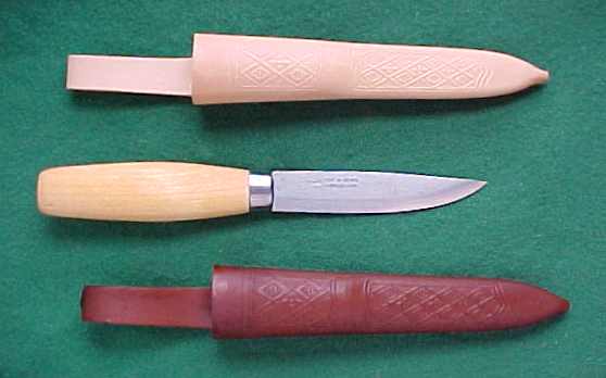

If he is building furniture or doing finish/trim work, a Frost Mora is a great blade for fine cuts and marking dovetails.
