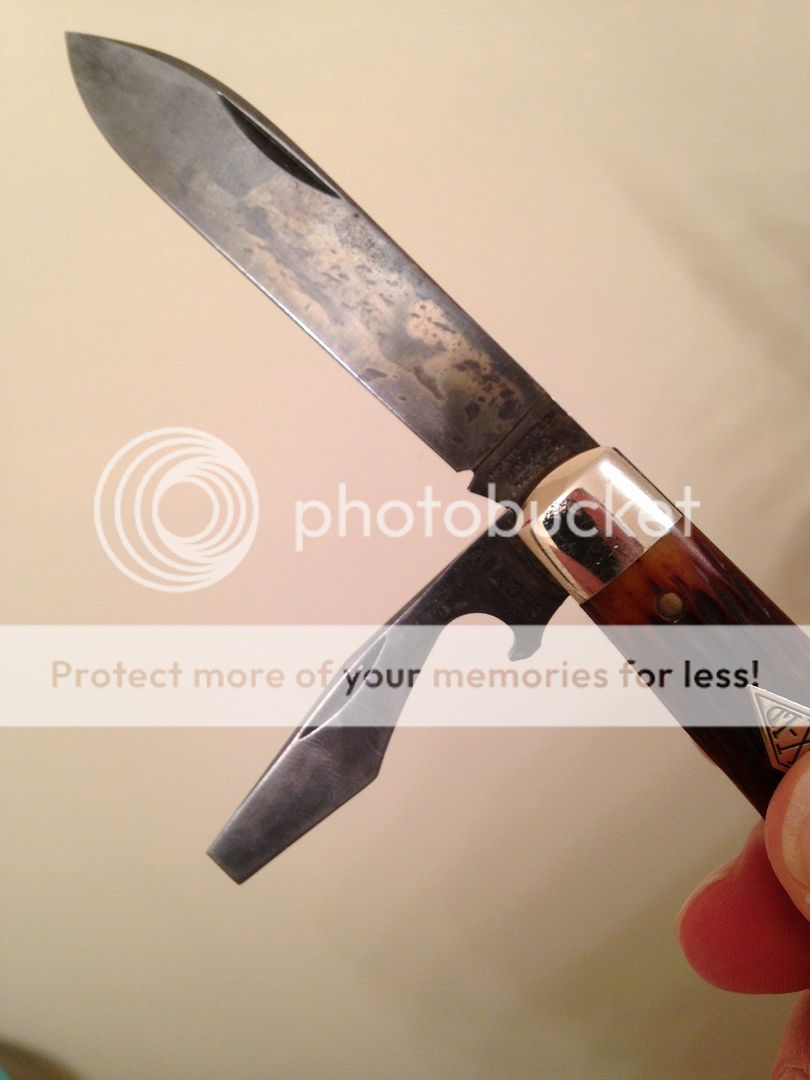

My GEC 15 Diamond Jack has gotten some heavy use here as of late and I have not been very good about cleaning the 1095 right away. Could I trouble the forum for some advice on how to even out the patina? I don't mind the darkness, just don't want the splotches everywhere. Any and all advice is appreciated
It looks perfect just the way it is, in my opinion! As BH said, use it and it will even out. If you want to start over, polish it up with Flitz.
Just keep on using it and it'll turn dark and grey steadily over time. Possibly some darker spots like on this 66. My father has been using it to eat his daily apples.
I find that a night stuck in a potato tends to give an even black. The blade will stick, so it's probably safer to slice your way out rather than pull it.
But I also like the changing waves and ripples on a developing patina.
If you want even patina, than first remove the old one (with some polishing compound or very fine sanding pad) and then use a brush (or similar) and apply vinegar. Keep stroking over the blade with the brush with the vinegar so that the effect will be even. Takes some 10 - 15 minutes to get even patina. I did that to Spyderco Caly 3.5 (super blue steel, no cladding) and it worked very well. The resulting patina was dark grey and very resitent (the blade was not polished, rather fine stone-washed what might have helped there)
I just soaked these in warm white vinegar for 15-20 minutes.
O1 tool steel.
Case CV steel.

I love the uneven patina on your blade. It's kind of a marbling effect that gives it it's own unique beauty.
Looks great! Just to mention, Tru-Blue gun blueing solution works wonders. I used mustard to create a pattern, then blued it to darken the rest. Love the look.
