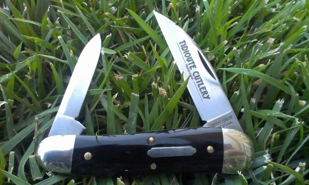

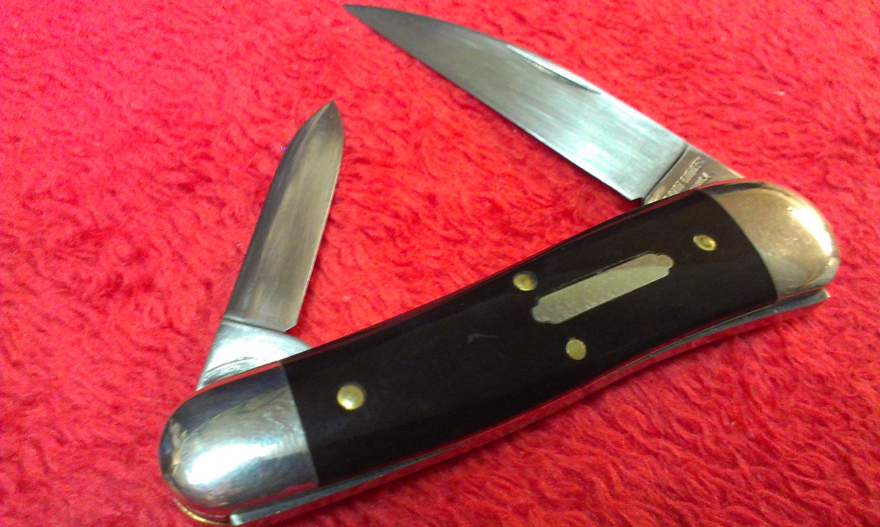

I re-ground my blades. Couldn't stand the geometry.
Factory
Re- ground
