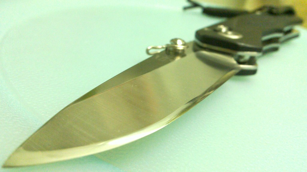

With the Lansky, if your progression is complete through all the stones, up to and through the 1000 hone, then going straight to the green compound on a strop should be fine. Both the 'Fine' 600 and 'UltraFine' 1000 ceramic hones from Lansky are capable of starting to polish (600) and very nearly finishing with a mirror (1000) on the bevels. Used with water in particular, they do well.
The knife in the pic below was re-bevelled using a Lansky Deluxe kit, and finished with the 600 and 1000 Lansky hones (included in that kit). At the time, the only stropping I was doing was with green compound on leather, so I'm sure I used it with this blade. Steel is ATS-34:

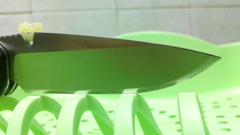

This knife is sharpened with cheap Daisho 320 and 400 grit stones (5$ each), followed with 1000 and 1500 grit sandpaper (1$) and stropped on cardboard (free) with MAAS compound (9$).
