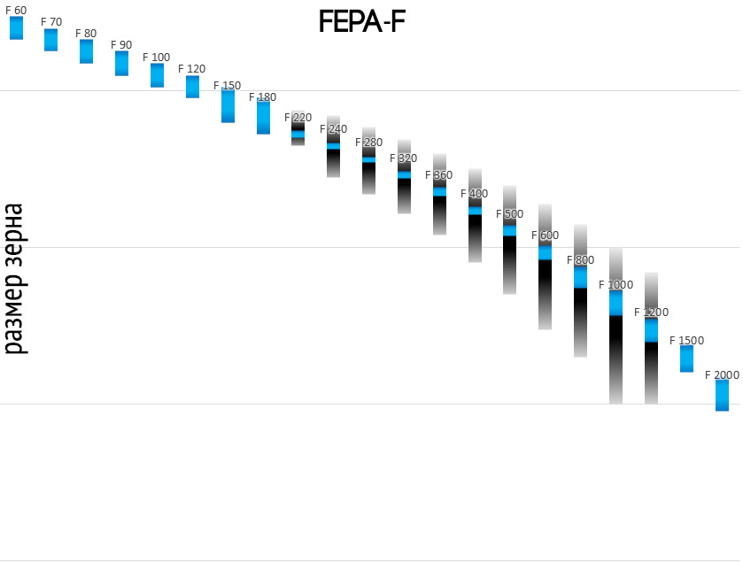

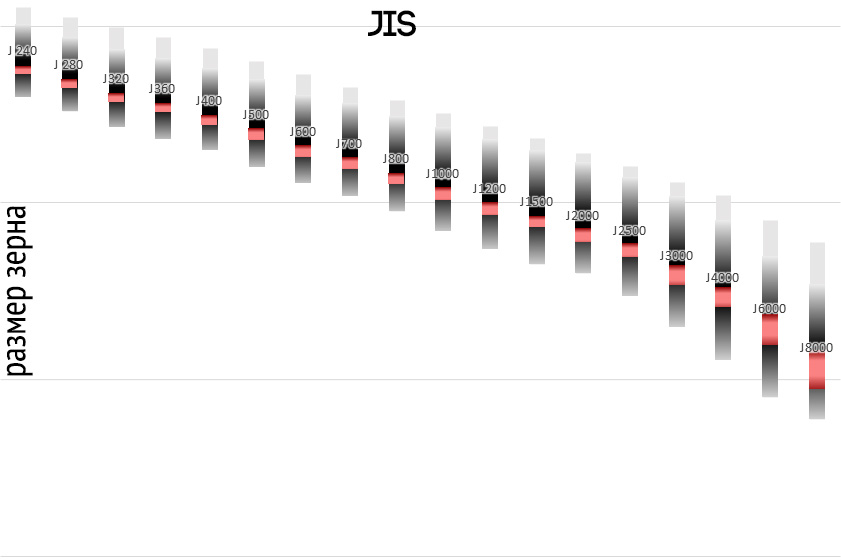

All national standards for abrasives are separated to bonded and coated version - FEPA,JIS,ANSI,GOST. :)
Grit designations under different systems have different ranges of particle size considered as acceptable maximum, minimum, and average effective size, all in microns.
It's even more complicated. Standart regulates maximum and minimum for the primary fraction, and also for the secondary fraction. Abrasive may contain very big particles or very small particles in small quantity as part of secondary fraction.
Colored sections are integral distribution of the primary fraction. Grey sections are integral distribution of secondary fraction.
%D0%9C%D0%BE%D1%8F_%D1%82%D0%B0%D0%B1%D0%BB%D0%B8%D1%86%D0%B0_%D0%B7%D0%B5%D1%80%D0%BD%D0%B8%D1%81%D1%82%D0%BE%D1%81%D1%82%D0%B8__6_.jpg
%D0%9C%D0%BE%D1%8F_%D1%82%D0%B0%D0%B1%D0%BB%D0%B8%D1%86%D0%B0_%D0%B7%D0%B5%D1%80%D0%BD%D0%B8%D1%81%D1%82%D0%BE%D1%81%D1%82%D0%B8__7_.jpg
