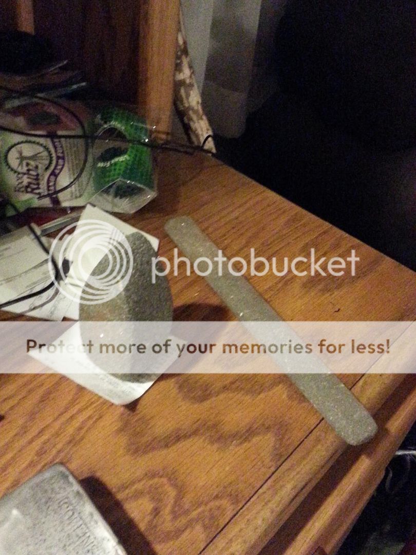

What is this sharpening stone?
Sep 3, 2014
3,741
I picked these up today for $1 each. The long one I have seen before, but don't know what it is. Some kind of scythe stone? Looks like sandstone. The other though, I have no idea. It looks coarse, and maybe it isn't even a sharpening stone, but I bet it is. Any idea what it's specific shape is intended for?

they look like carbide something stones to true sharpening stones and grinding weels
The one that is shaped like an iron looks like some sort of scouring stone not necessarily a grinding stone.

The one on the right looks like an "American pattern" scythe stone.

The one on the left,
I’ve seen tillers using something similar for ‘flattening’ floors when laying tiles

Scouring stone, that's interesting. The shape must be for something, and it isn't pumice, so not sure. I bought it not far from the original Ames factory in Easton Ma, so my mind went to shovels. I have no clue.
Now that I think of it an old timer (cement finisher from the 1960s) lent me his journeyman tool kit 3 decades ago and told me the shaped man-made stone in there was to scour the highs off green concrete and to clean up corners and edges immediately after forms were stripped.

The odd looking stone, like stated, is more than likely a carborundum rubbing stone. They are used to finish the edges of green concrete once the forms are removed.
