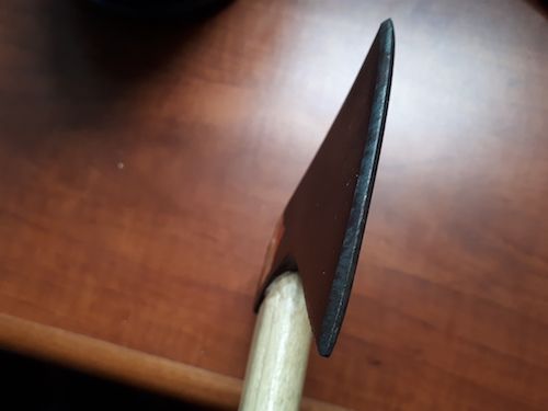

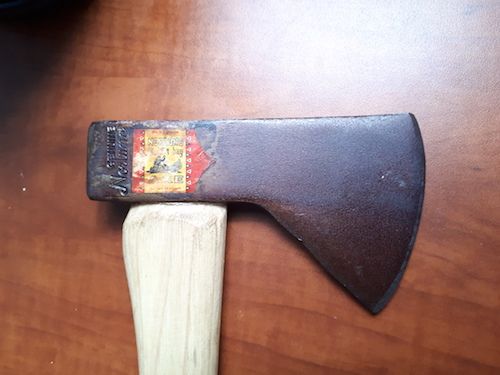

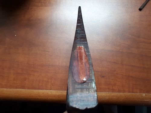

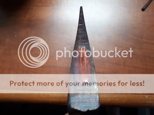

Hey guys, long time lurker here, decided to ask a question.

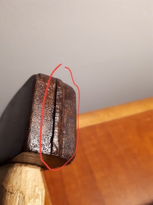

I picked up this pretty much unused Norlund "Tomahawk" the other day and noticed a weird thing going on with the Butt/Poll. It has a straight line ridge going down the middle, which makes it useless for pounding stuff unless I grind it down.
Is this normal? Did someone forget to grind it flat at the factory?

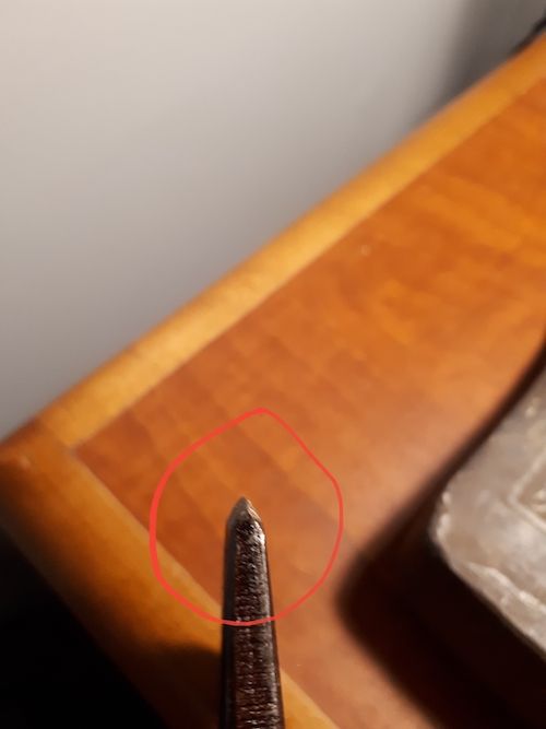

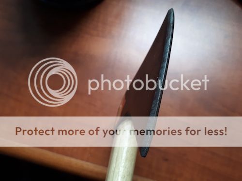

Also, It has a STEEP SHORT bevel that I hate. Is this how they came from the factory, so you can sharpen it yourself? Whats the best way to fix it?
Thanks!
How likely is it a fake? I've searched everywhere for "fake norlunds" and come up with nothing substantial differentiating the two. Thanks for the input

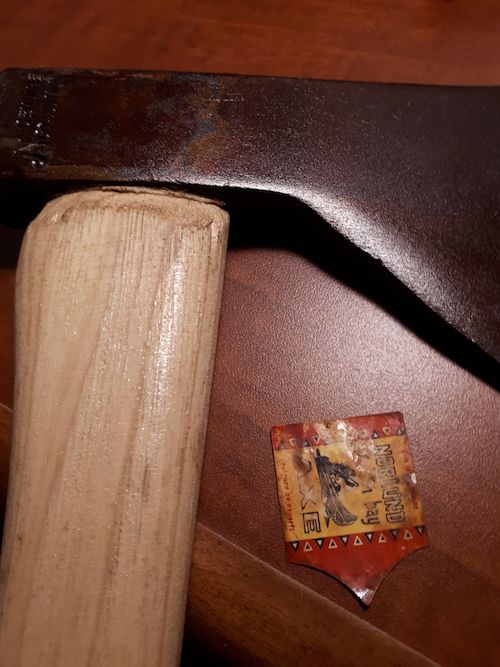

I've attached the stamp by the poll and the stamp that was attached to it but fell off.
My impression from your pictures is that it is likely a “Norlund” and definitely the right pattern but it was made later on when production became a bit “sloppy”.

Can we see another picture of the whole axe showing the bit?

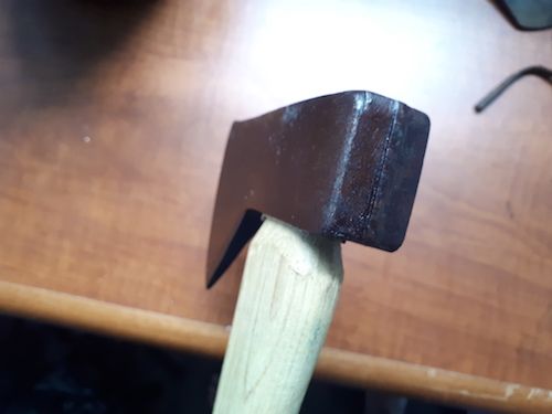

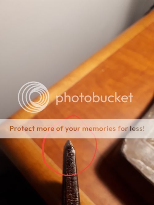

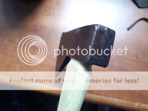

Thanks for all the feedback everyone! Any more advice, help is much appreciated. Here are some more pictures. It has a metal wedge in the eye, don't know if that signifies later manufacture or not but thats what I would guess.
I would say it is late model Norlund. Off center wedge, sh.....ty grinding job. Probably produced on Monday morning, day after Super Bowl binge drinking.
The good thing, unless the heat treatment is messed up you can sharpen and re-haft it straight.

Your example, if you desire, will clean up just fine with hand or power tools.

Looks like the eye is punched at a skew to the rest of the head, even.
The "line" on the poll is the parting seam from the drop forging, and was normally ground off. It would have gone all the way around the head. Someone just forgot to grind it off the poll on this one.
