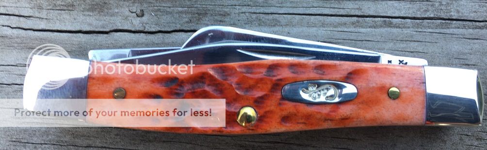

I thought they were tightening down on QC with their knives.
I ordered a Stockman CV chestnut bone which arrived this afternoon. Fairly recent production. I ordered it online and I usually only pick them up from a local store after I hands on check it out.
This knife came with the worst blade rub I have ever seen, the "chestnut" is cotton candy pink for lack of a better description, and the shield is actually upside down. I've seen some of their "pink" scales but this one is wow. I wish I had my phone with me to upload some pics.
The thing that get's me with this is someone looked it over and said "Yep good to go" and sent it out. I think anyone even a non-knife nut like us would look at this and say wow wait a sec.
Back she goes.

Nope the rubbing is not caused by push, it is rubbing. If you look you can see the center blade is right up against and dragging.
I also took a shot of the color like I mentioned and the shield. Not the greatest pics but it's what my phone can manage.
Thanks for posting the photos. :thumbup: It is the first time that I've ever seen photos posted when someone complained about rub and I've seen a lot of complaints. It does seem to have a problem. I don't have this pattern except in vintage knives (the vintage 32 from the early 70s or earlier is a personal favorite). There looks to be no room at all for any space between the blades. I wonder if this is a common problem with the pattern. It's not a problem with my modern 47 stock knives.

All of the two-spring stockman patterns I own have blade rub. Including GEC, so it's not just a Case thing. It's the nature of that design with a crinked blade.
I have a couple of 032 Stockman patterns and they have blade rub on all three blades. So do '18s, 44's, and '75s, to one degree or another. Doesn't affect their operation at all.
The color is rather light on that one and the upside down shield is amusing. If you don't like those issues, you should return it. If you don't like blade rub, I would avoid all Case patterns with crinked blades and stick to some other brand.
Every stockman I own has blade rub with the exception of a Northfield maverick and a 50 year old schrade. It's typically insignificant and as long as it doesn't effect the edge, it doesn't concern me. Congress patterns suffer the same. Like Mike said, 3 to 4 blade patterns often have rub. Anytime you have more blades than springs. The thing that I couldn't tolerate about the op knife is the color. I have a lot of chestnut case knives and though some are lighter than others, that one is just bad. The shield is comical, I would actually choose one like that for it's singularity.

From the looks of the OP's knife the blade rub on this knife may be more of an issue with the design than the quality control. There's no room at all.

I mean when crinked blades apply lateral pressure against one another when in the closed position. As they are opened and closed they rub one another resulting in the marks visible on the op's knife. When you construct a slipjoint that has more blades than springs on opposing ends of the knife, this lateral pressure occurs once the shims are removed after peening the pivot pins. It's not uncommon which is why I said your examples are quite nice in that they don't appear to have this issue. Perhaps another maker could tune in and articulate this better than I have.
The $20 Schrade Old Timer (above) is crinked with no rub. It's a bit more tricky when the blades are crinked rather than offset. I think the early Case sowbellies are crinked a tiny bit. There's a mix of (relatively) old and new sowbellies in the photos above.
I think it could be a "per individual knife" issue. It really all comes down to how the pivots are peened including force, strike angle, etc. A custom maker will take the time to re-peen to avoid rub but mass production will likely just send it out if the edge doesn't contact. It may be why most custom makers stick to patterns other than stockmans and congresses, they are a pain.
