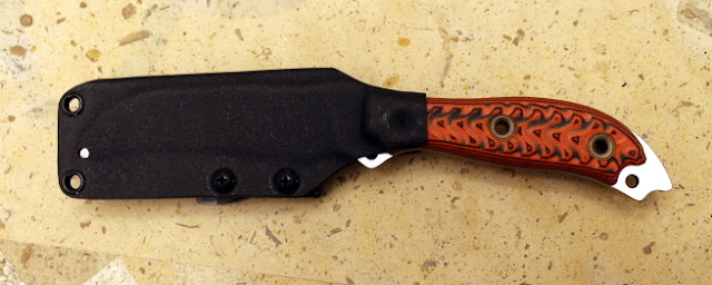

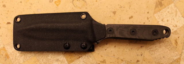

Another vote for kydex and a Teklok.
I hear wonderful and terrible things about klydex

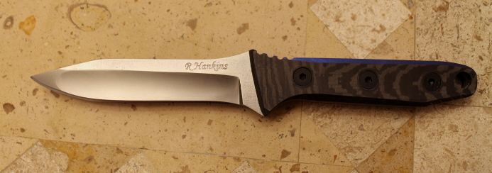

The only negative of properly made kydex is that, when stuff gets inside the sheath or is on the blade, it will scratch the knife. Sometimes very deeply, requiring sanding to get rid of the scratch. Even one tiny bit of sand can do it, because the flat inside of the sheath pushes it against the flat steel of the knife blade.
I will not be quitting kydex anytime soon on my user knives, but I've moved away from smooth sided knives (that scratch easily) to coated or stonewash finished bare steel knives. The stonewashed finish, or coating, gives sand or dust or whatever a chance to get caught up in the low spots, so it isn't sandwiched between the flat sheath and flat steel.
What is this knife, please? Looking at the handle, I need one...
It's a Hankins Slim Chance fighter. Very nice knife.
