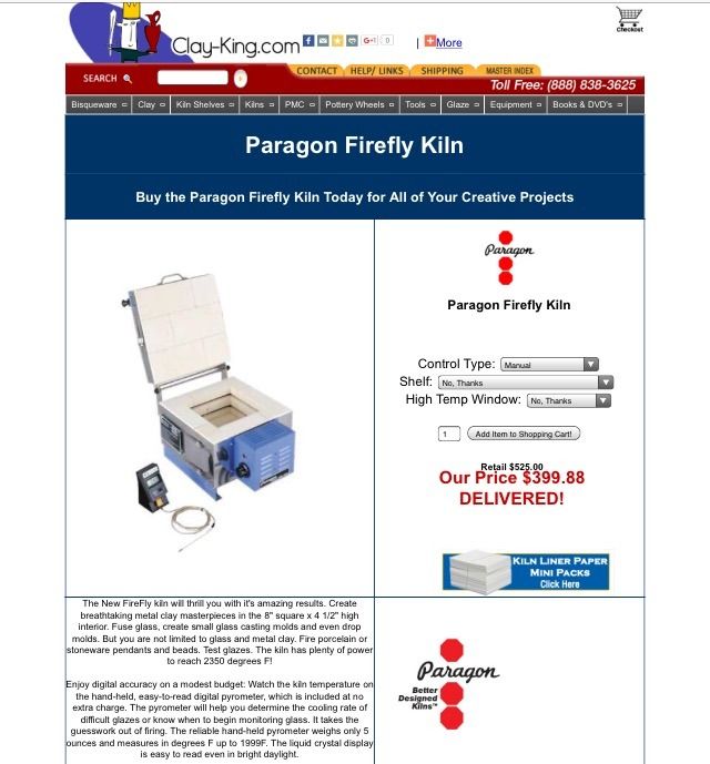

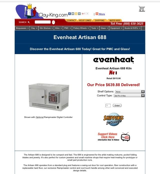

So looking trying to decide on one of these ovens.
The paragon heat up to 2300 ( stainless in future)
The even heat 1900
They seem to fit the bill for me.
What are your thoughts before I order ?
I would not get either of those. Here is the minimum kiln I would buy.
http://www.clay-king.com/kilns/evenheat_kilns/evenheat_kh414.html
I have the 220v version
http://usaknifemaker.com/knife-maki...ter.html?SID=0e9d0f42db78f6837420ebe9772280be
I have been using mine for 10 years with no problems,this is one of those buy once, cry once items.
If I had the money I would definetly go that route.
That price is way beyond my budget.
This is going to stay a hobby for me and I only work on one knife at a time.
Are you saying neither will work?

Taximanny --I'd take a hard look at a bigger oven than that, what they say in their add is its good
up to 1900 for the evenheat? Thats not enough for the soak on a lot of ss. I've had an 18" evenheat
for17,18, ish years now and replaced one thermocouple a couple of years ago. As far as shipping
them out for HT thats an option. Not so much advice as trying to smooth the road.
Ken.
Yeh I'm with Ken,wish I had bought the 18 when I got mine. But TKS is close and if I make anything over 12" I take it there.
The evenheat atrisian will work, it goes to 2000 deg so it will do most stainless but will limit the size of things you can make.

A tiny oven for folders is a good idea, and if you have space issues tomorrow you will get a bigger one but still use the tiny for folders, trust me.
Be aware of top opening ceramic kilns, way better side opening.
I went ahead and ordered the Evenheat Artisan 688
It will do the job I'm asking of it at the time.
If I ever get into bigger fixed blades,,, than I might send one of those off...

I have the 688 even heat oven. if all you ever do is folders then it will work out perfect for you.
If you decide to get the bigger even heat then ask for the bill burke special. this will add a little extra insulation so the shell doesn't get so hot at high temps. also There is a new controller in the works that would definitely be worth waiting for.
