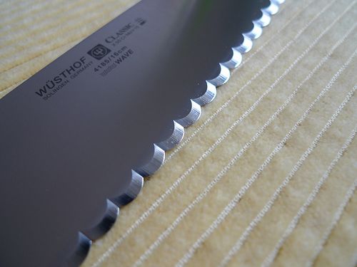

I've run into a kitchen knife type I've never seen before. On one side it is a normal smooth surface but on the other there are ridges perpendicular to the edge, about 1/4" long coming up from the apex and about 1/32" apart. (Those measurements are just from memory.)
Does this edge have a name? Can I sharpen it with a sander?

reverse scallop? hahah
disc serrations? circle serrations? round serrations?
I'd also call them half wave serrations, because I have a bread knife which is full wave serrations
you could sharpen this by sharpening the flat side on a stone to raise a burr,
then cut the burr off on something skinny that can reach between the circles,
like sharpmaker triangles, sandpaper over wood...
You can sharpen those blades with something like a Handy Sharp or another brand of carbide sharpener. Sorta, kinda. I tried it to see if it would work and you end up sharpening the peaks of the scallops. You could probably do the same thing with a stone but I think a stone would take off a lot more metal. The only blades I have seen that edge on is a cheap knife with a really thin stainless blade. You can sharpen it but the edge won't last long.
Sounds like the serrated edge you find on kitchen shears. The actual edge is straight, but there are notches cut into the edge bevel so essentially the edge has both a 25 degree and 15 degree bevel, interspersed.
The miracle blade steak knives have a similar pattern to the wusthof except they are ground on both sides, for some reason I've always thought of them as butterfly serrations
If I ever do bother sharpenig them my plan is pretty much what has already been said in the thread, just focus on getting the high points sharp again but since I don't care about the knives it won't bother me if I flatten the radius of the serration a bit
It would take an awful lot of work to get them to factory new condition again if its even possible, so if that's what you are after I would contact whoever made it and see if they sharpen them or have any suggestions

Really would be best to see a picture of the edge. All other input or suggestions would be purely speculative without seeing what the edge looks like, and it may turn out to be much simpler than most would assume, going only by a verbal description. If this is a typical 'grocery store' kitchen utility knife, I have an 'OXO' branded kitchen utility knife, bought at the grocery store, that looks (vaguely) similar to what I think you're describing, with a very tight & tiny-toothed serrated edge on one side, formed between those closely-spaced 'ridges perpendicular to the edge' extending to approximately ~1/8" behind the apex, with the back side of the edge being 'smooth'. The 'ridges' on mine number about ~34-36 per inch. BUT, I don't know if it is the same or even similar to what you describe; hence the need for a clear picture of what you've got. OR, at least identify a brand & model, if you've seen another one like it at the grocery store. With that info, it should be easier to at least look up an image of what the edge looks like.
It may be as simple as sharpening only on the 'smooth' back side of the edge, apexing only from that side and perhaps stropping with a fairly aggressive compound on the front (ridged) side, to knock off any burrs formed from the back. In reading this thread and considering ideas for approaching it, I've been trying that technique with the knife I have, and it seems to do just fine.
