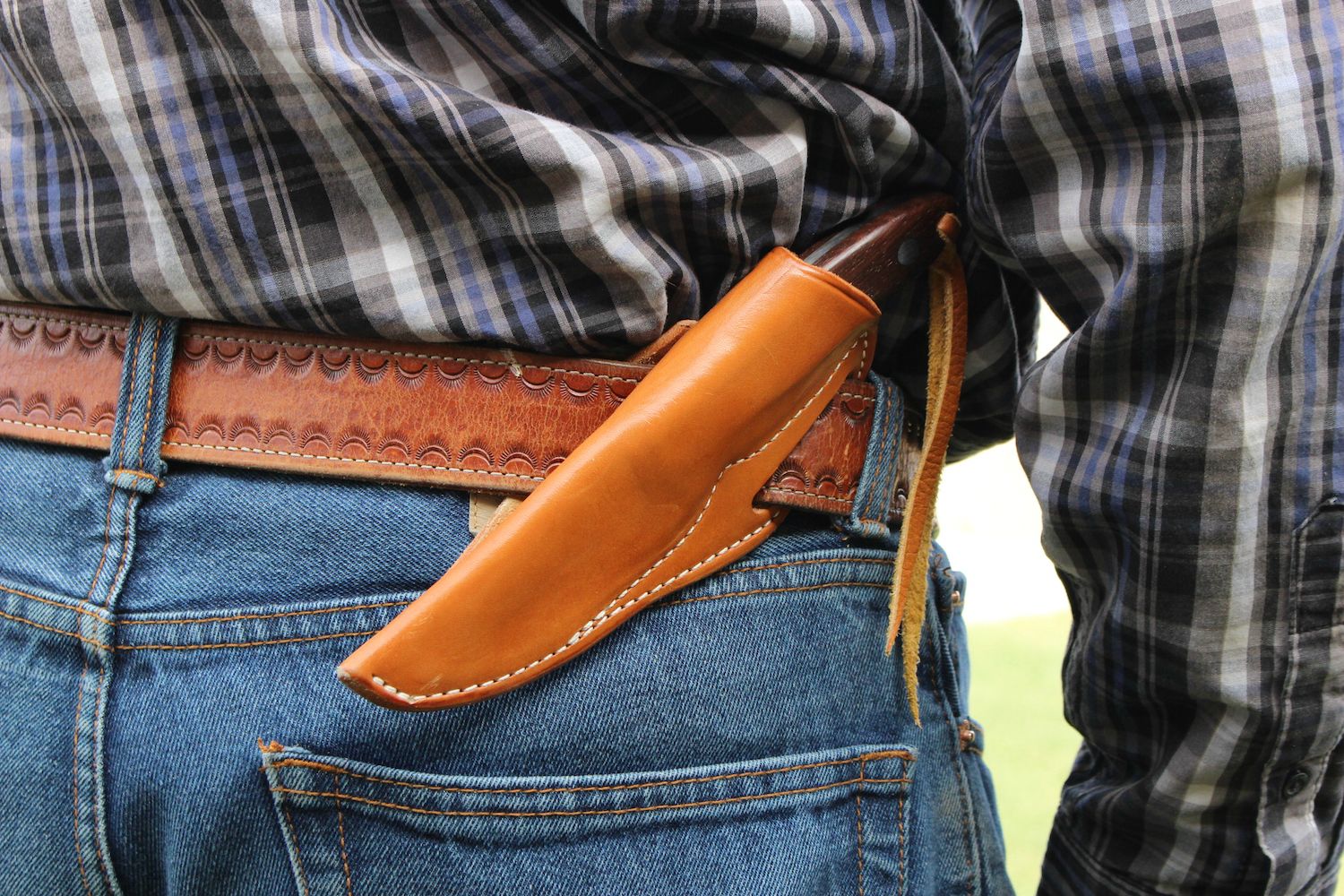

On sheath work I occasionally use the tubular rivets to make a Slot and Loop sheath where the loop is riveted to the sheath. Thats a bout it. I did use them on that bowie suspender thing to attach the d rings. I'll see if I can find a pic of a Slot and Loop sheath.
Found some:
This shows the backside of a Slot and Loop sheath with 2 nickel tubular rivets. So the sheath carries like this:
Or it can be carried upside down like this one:

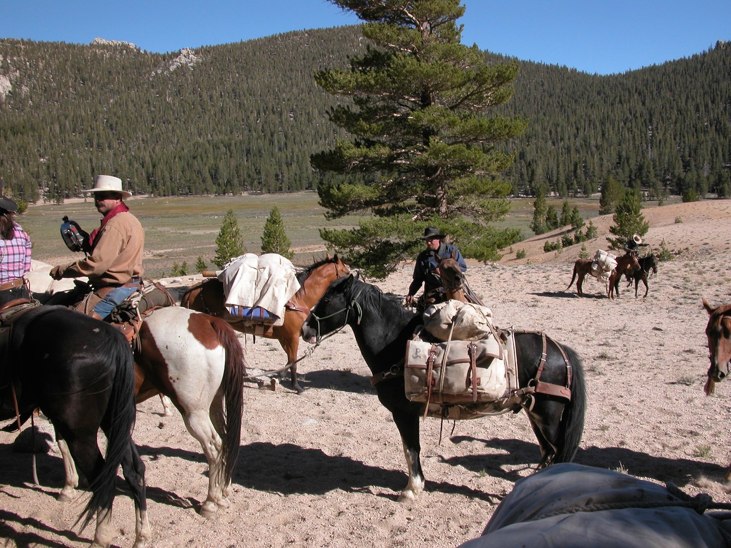

Basically there are two types of pack saddles, a Sawbuck and a Decker. A Sawbuck has two sets of crossed wooden uprights to which packs or panniers are hung and the Decker has metal arches that seve the same purpose. There are some regional differences with Deckers more popular in the Rockies and Sawbucks more popular here in CA. The Deckers are more versatile in what can be carried the Sawbucks are easier to pack. Both are basically trees with numerous straps attached to secure the tree to the horse with front and rear cinhas, breast collars and britchens (come over behind the horse's hip and prevent the saddle and load from sliding forward. All of these straps are just riveted together. Almost no sewing. In this pic there are a stack of 5 pack saddles on a log. Bottom two are Sawbucks as are the top two. There is a Decker in the middle that I can just see one of the metal arches and that canvas thing in the middle with the board is part of a Decker.
In use:
