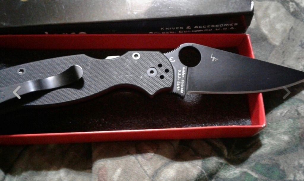

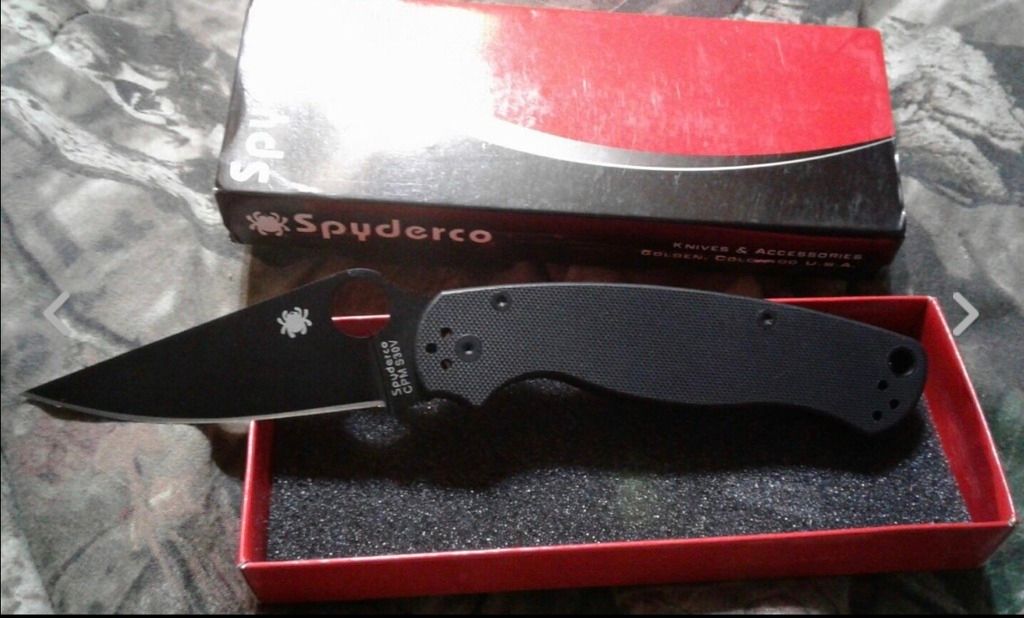

I ran across this knife today on Craigslist. I've tried asking the seller for the model number and pictures of the box. So far I have not gotten a clear answer other than it is a CPM S30V which I know is not the model number. It looks similar to a paramilitary 2, but I am not sure. I would appreciate any input on what kind of knife it is. I apologize if this is posted in the wrong spot.

The easiest thing to start of with is by asking for a close up shot of the non lock liner inside. There should be two holes as spyderco skeletonises the liners. If you see only one hole, you know this is at least wholly, or partly, a fake. YouTube videos discuss this in detail. If you see two holes, however, you still need to consider the other pointers, but this is the easiest one to check, and you'll know immediatelly if you just see the one that you need to back away.
Also, AFAIK, the PM2 comes out of the box tip down carry. Did the seller move the clip?
Thanks for the help guys. The guy hasn't responded to my emails since this afternoon. So, as of right now I will stay away from this knife. I don't know if he moved the clip, but I have looked at real pm2s and this one does look off to me.
I can tell by the texture of the G10 as it looks much smoother than it should be, and uneven to boot. Also note that packaging. Spyderco does not use such a porous black padding. You can see through that. It screams fake. The real problem is he is playing dumb. He knows darn well it's a fake but he's hoping somebody will fall for it.
fake paramilitary 2 and yes he did move the clip b/c genuine paramilitary 2's come with the clip in the right hand tip-down position
Definitely a fake PM2, first dead give away was the font type and size is completely wrong, on top of many other things like a fake looking box. Report them.
Yep, another fake PM2. And not even a good one!
Instantly noted that the symbols on the blade are wrong, the jimping is wrong, and the font is wrong.
