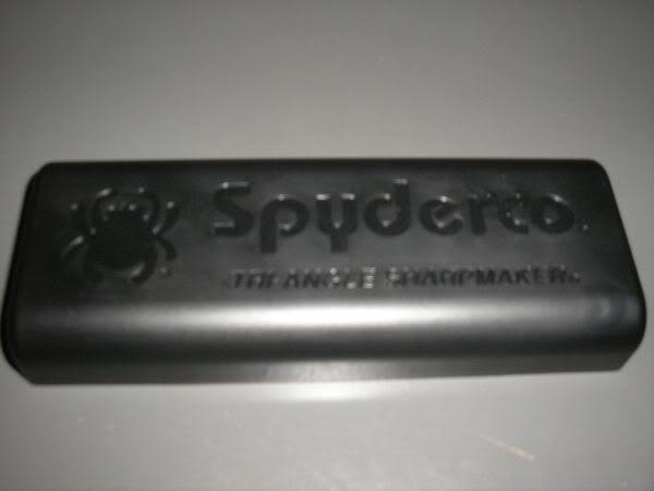

I was curious to know what kinds of sharpeners everyone is using. Pictures would be nice on your sharpening setup.
I'm very basic(Not much knowledge :p). I'm using a Spyderco Triangle Sharpmaker.

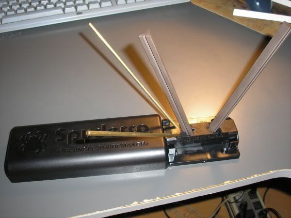

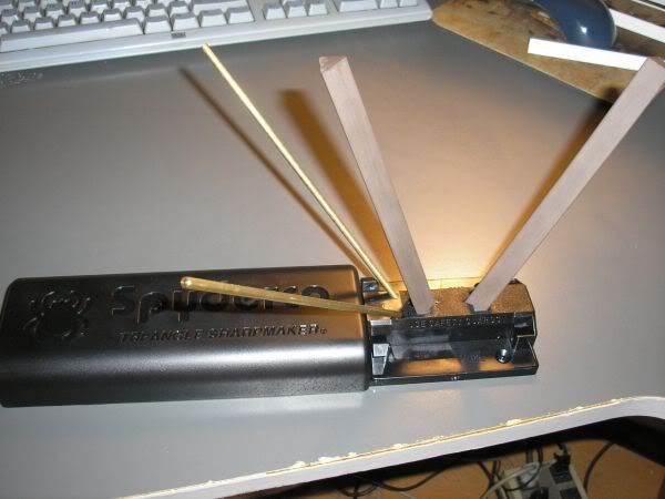

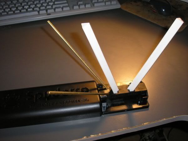

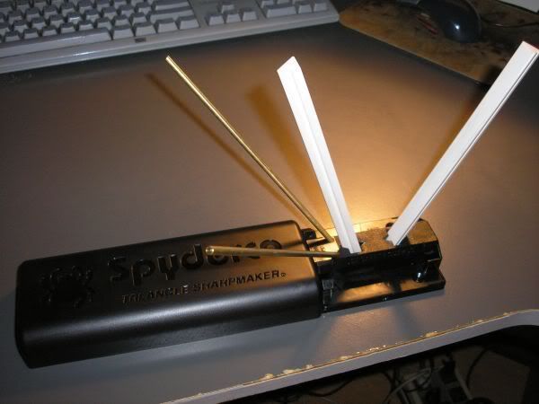

Update: I just cleaned my rods with these soap pads with powder cleaner, and wow did it make a difference.
I've only had the sharpener for 2 days :p
Do they really need to be cleaned already?
It looks like you've been sharpening a lot of knives. :thumbup: I would suggest to clean the stones at least every 2-3 knives. You will feel the stones getting "slick" and lose their "bite." When that happens, its time to clean them up with a scotch brite and some commet. :D You can feel the difference of clean stones vs dirty ones.
As I said, i have these pad things with built in powder cleaner. It makes cleaning so simple. :D
