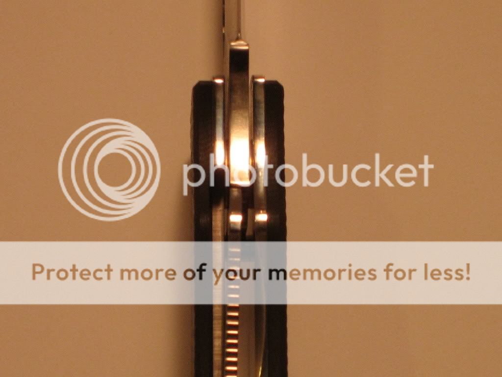

What do you think about this liner lock?
Being thicker, does it mean longer life?
Pic stolen from the spyderco forum:
http://spyderco.com/forums/showthread.php?t=41304

That's about as solid a liner as you are going to get. You'll probably wear the blade down before that that will wear down.
