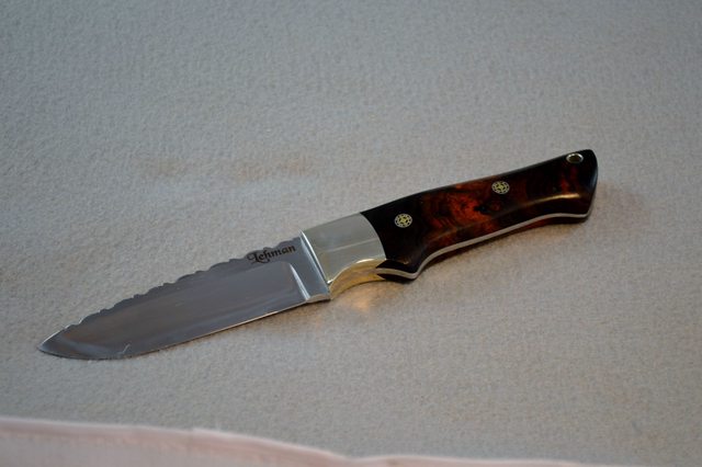

I haven't made a lot of knives but I would like to think they are coming along pretty well. Examples are linked below. I started with the Grizzly grinder and still have it but I graduated to the TW-90 a couple of years ago. The Grizzly has some faults but it is a good machine with decent power. Some minor mods will improve the machine's effectiveness. On a budget it's not a bad way to go. My major pieces of equipment are the TW-90, Evenheat oven and an older Craftsman drill press. I have a lot of other stuff like files, clamps, calipers and other odds and ends that help. I do not have a mill or lathe. Excellent work can be done with very basic tools. Some of the best tools are those you make yourself like sanding sticks, hand sanding fixtures, broaches and other things that make life a little easier for a knifemaker. Even with big ticket items in your shop, knifemaking is still a lot of work. Any way you slice it your greatest tool will be your determination. You just have to give in to the fact that you will be busting your butt. So whether you have lots of equipment or just a few hand tools it comes down to you. As others have said, tools don't make the knife, you do. You know what the thing is supposed to look like. Just don't move from one step to the next until that stage is right. And don't quit. Every one you finish, and finish well, will give you that much more drive to build the next one.
