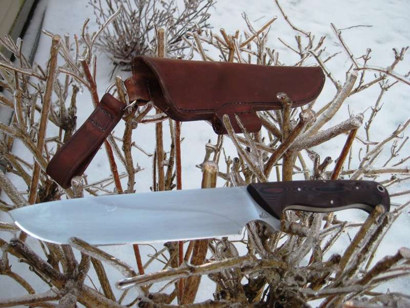

I have this large camp knife made by NWA. It's a 1/4" at the spine, but tapers down to a beautifuly thinned edge. I have had 1/8th inch knives that wouldn't cut as well as this knife.
The RC-5 is built to be a tank of a survival knife, that will take all kinds of abuse. So it has a pretty thick edge for handling that. It cuts ok, but once you knock the shoulders off that thing and put wicked sharp convex edge on it; it becomes a mean slicer and still retains its tuffness!
So in summary, with the right edge geometry, a thick knife can handle all kinds of tasks.
