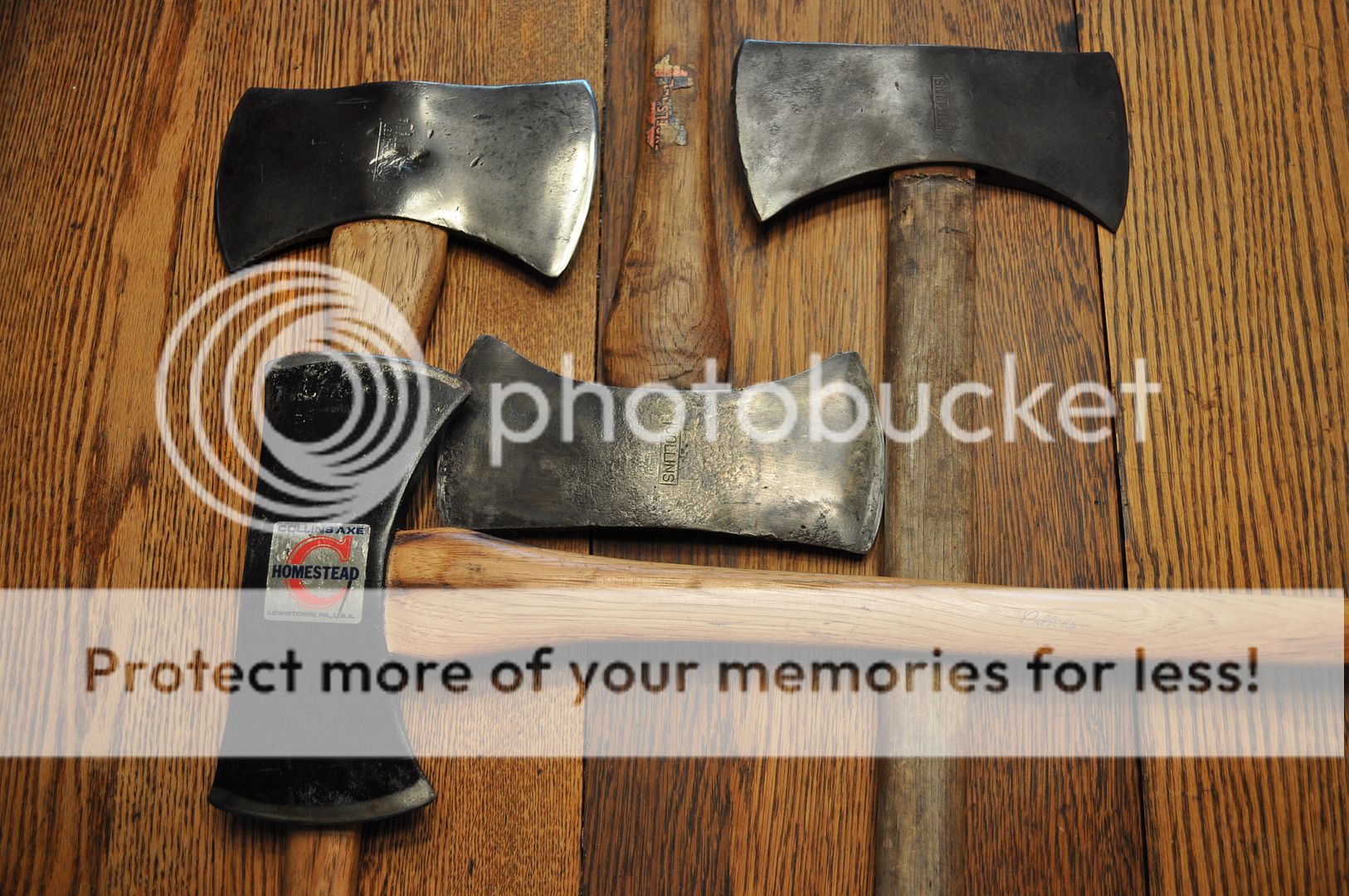

So, the question is: what makes a double bit a cruiser? Is it size? Or weight? Or both? I am very curious to know and like to know what y'all say.
A cruiser is a double bit axe. Typically 8.5" from bit to bit w/ bits from 3.75" to 4.5". It has a smaller eye than a full size double bit. Most have a handle length of approximately 28"
What Tom said and consider weight typically at 2.5#. And they're fricken awesome.
Ok, what if the dimentions are as Tom described but a weight of 3.5#?
I just picked up one, right size, smaller eye but heavy.
Only marks are 3 1/2 on one bit and 'HK' on top by the eye. Seems nice.
I have one similar to what you describe, looks like a cruiser in profile but it's got edges that are a bit thicker and it's heavy.
I'd say it's just had a long life as a user and many sharpenings have reduced the size of the bits somewhat while not reducing weight very much.

That's not a cruiser, you have a full size axe.
Cruiser axe is named for timber cruiser. In the old days a timber cruiser would spend days or weeks in the forest looking over tracts of timber. He needed a lightweight axe for camp chores, blaze lines, mark trails so a smaller and lighter axe was in demand for those tasks.

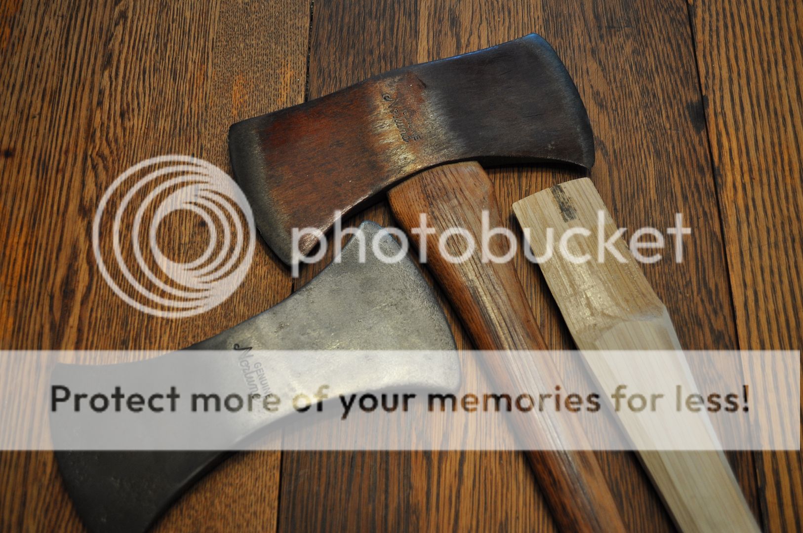

Thank y'all for the help. It's not full size (compared to my 6 other double bits) but it is 3.5#.
Not full size, but full weight. Not light enough to be a true cruiser, but a really cool little chopper none the less.

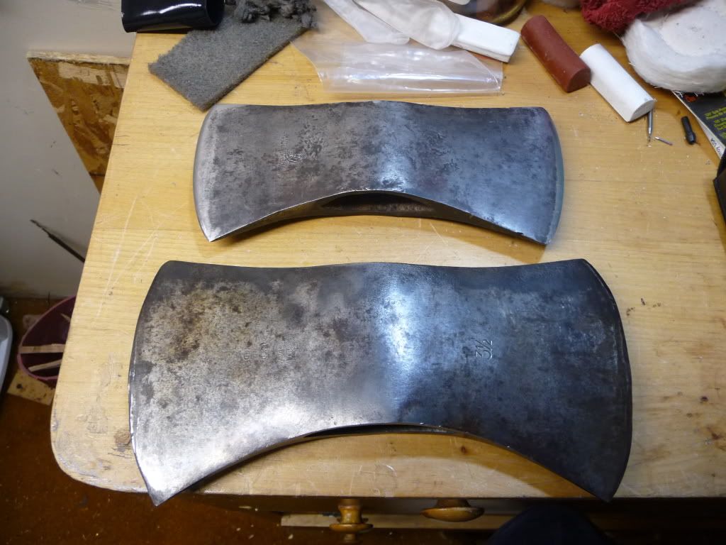

Eye size. It needs to have a cruiser eye. Otherwise it's just a worn out full size with very little of the tempered bit remaining.
Weight is a factor, too. To me a cruiser sized eye on a 3-1/2 pound head is still a full sized axe. I think a true cruiser should be 3 pounds or less original head weight.
She's marked 3 1/2, comes in at 3.457#; has a cruiser eye and is 8 5/8 inch bit to bit (widest points).
It's thich though. Eye walls at the thinest point is 1/4 inch.
It does not show much use.
It's an oddity but I kinda like it.
