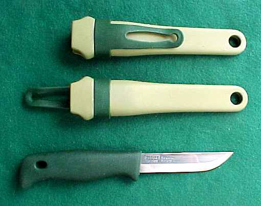

RWS, I love the "main" knife you're ordering from Ragnar - very pretty indeed, though yeah, a bit hefty for most of the birds or trout I'm likely to meet. I've got a love/hate thing going with the plastic handled Moras though ... great steel, but I hate HATE the plastic handles/sheaths. However practical and cheap. Wouldn't be surprised if the River Gods agreed ...
Gotta agree witcha. My leatherwork is just now getting slightly better than the ugly plastic stuff. One temptation I'm considering is taking one of those super tough differentially tempered plastic handled Moras and rehandling it.....
