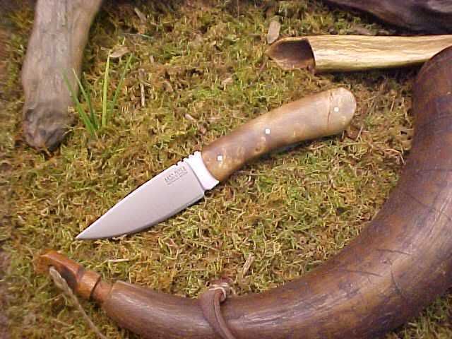

Bark River makes a bunch of small fixed-blades that work great for patch knives. Carry them however you want. :P

Some patch knives made today are chisel ground to allow a full flat side against the muzzle. One's I've seen pictured are 3-4 inch blades with either a round or flattened diamond profile handle, which is considered somewhat more authentic. The ridge runs down the middle of the handle, which shouldn't be uncomfortable given the flatness of scales riveted to the tang. Clasp knives - friction folders, or Spanish style ring pull locks are used, too.
Sheaths come in too many varieties, but some just use a sash wrapped around the waist and tuck knives into the folds. Possibles bags were used by some - clothing had few pockets, so knives with small sheaths could simply be tossed into them.
