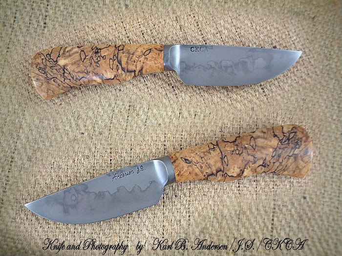

yeah i like the more whispy ones too and if its got a false edge it should turn back on itself ;)

I like the thicker, cloudier hamon's myself..but like it was said, has to be the overall package. I am in love with Don Hanson's stuff...and if i ever have a lot of money, i will own one :) I just attempted my first one, and it really isn't as hard as i was prepared for, but i think the overall characteristics add aesthetics as well as the knowledge that a proper heat treat process was done.
Those are some very elegant knives, Karl. They look just right to me. Are those 1095?
Don, re-reading my earlier post, I don't mean to suggest that your blades are NOT well-polished or complex- they are certainly both. But I'm sure you know what I meant. It's interesting that you say Fogg's blades can be less dramatic in person than in photos, usually it's the other way around, hamon photography being what it is. I've noticed myself though, that you can with care and light make a hamon look more intense almost in a photo. The detail in Don's steel is what I'm personally light years away from getting yet, both in steel or a photo.

No offense. I know what you mean. Mine are not taken to as high a polish as Don Fogg's and I do a more harsher etch.
What I mean about the highly polished blades in person, is you usually have to get the light just right to see the hamon. But the high polish brings out more activity. Fogg's blades are very dramatic, but he has learned to make the hamon very dramatic in photograph. I have looked at a few of his blades in person and his work is what got me into this hamon mess. It's a sickness :D
