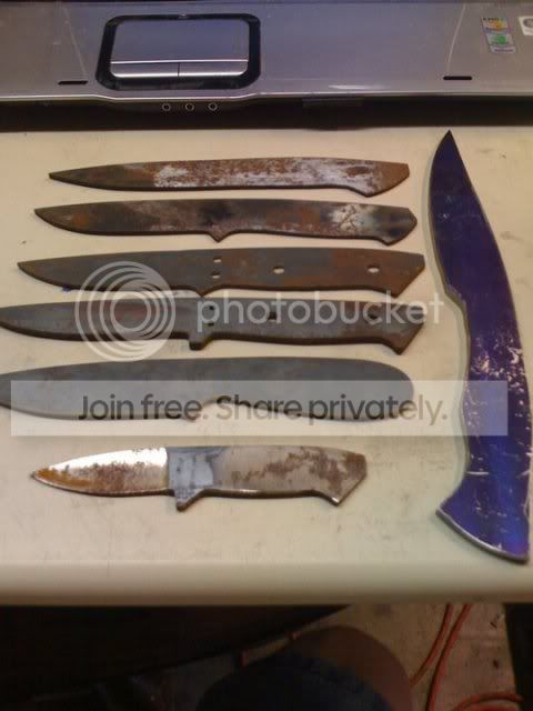

I agree with him as well. It's the style that Loveless used that is so very distinct. The picture below is the WIP for me right now. I'd say that 5 out of the 7 are "Loveless style" knives.

So this is kind of what I am talking about.
This blank I am working on here
would you call it a (LS) I am getting tired of typing it so I am going to refer to Loveless style as LS from here on.
The shape of this blank I have profiled out reminds me somewhat of what the LS.
I have plans of doing nickel/silver bolsters on this one and with the shape it seems like it might fit the bill as a LS. Now mind you I am not looking for a conscience clearing statement that would allow myself to make a poor copy to be identified as a LS.
This blade I have profiled out it is not SS. However I have seen one the other day that was referred to as LS and it was a 1090.
Does the fact that the knife is not quality SS or even SS exclude such a knife from being a "Loveless Style".
I am truly looking for the things that each and every one of you see in a particular knife shape, fit and finish that defines that piece as an LS!
Is the term to widely bantered around now. Don’t just say that at least five of these fit that bill for LS, explain why you feel that way. I won’t shoot you down I just want to hear different opinions on this subject
Inquiring minds want to know!
Your blade shape is reminiscent of a LS. The significant difference it the handle. As recommended above I would look at as many books and pictures as I could and get much closer before I used the term LS. Maybe Loveless inspired?

Now to try and put this discussion back on track. This question is not about the man or whether he collaborated on his knives! There was something about the knife blank (I pictured early in the thread) that reminded me of a LS. Honestly I am not sure what but it got me to thinkning and that prompted the thread and the question.
Now I realize it is the completed package that denotes a knife as LS, and I am not by any means trying to compare any of my work to that of Bob Loveless. How ever I see that term LS bantered around quite easily by some when describing one of their pieces. So it got me to thinking. Is this just a marketing tool or can the details of a piece that is classed as a LS actually be listed.
