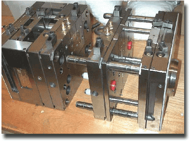

Examples of injection molds I found off of Google- so you can get a basic idea of what we're talking about.

This was very insightful, I thank every one of you for chiming in. Looking at the pictures of molds and reading what is involved, it is easy to see why they are so expensive.
