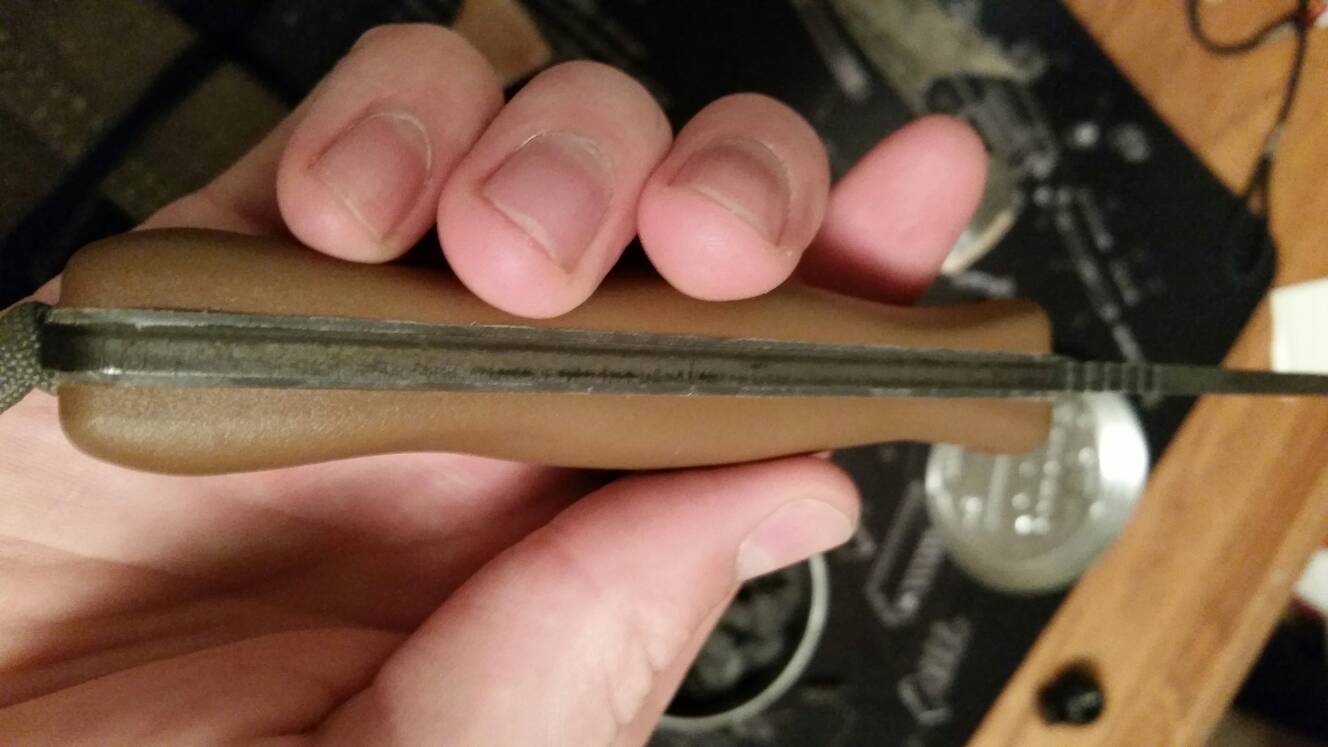

I tried making my first set of liners for my 16 tonight. Used a clear DVD case and cut them out with an exacto knife followed by sanding. It improved the feeling of the tweener handles immensely! It's crazy how much of a noticeable difference it made. The thinness of the handles was my only complaint about the 16. Liners seem to completely fix this. However, I now have an aesthetic issue. The liners I made are pretty ugly. I'm usually not a form over function guy, so I'll keep them for now. I wish someone sold liners with a good fit and finish. Aikiguy, how did you get yours to look so good?
Here's the evidence.
Hey do t worry CB, mine looked like that too at first. Keep upping your sandpaper grit - I think I finished at 1000 or 1500? - and then a few passes with a heat gun (or maybe a hair dryer) and it should get rid of all the white spots. I took everything off the knife and just sandwiched the liners and scales together when I did this. Helped keep the coating intact around the handle.
